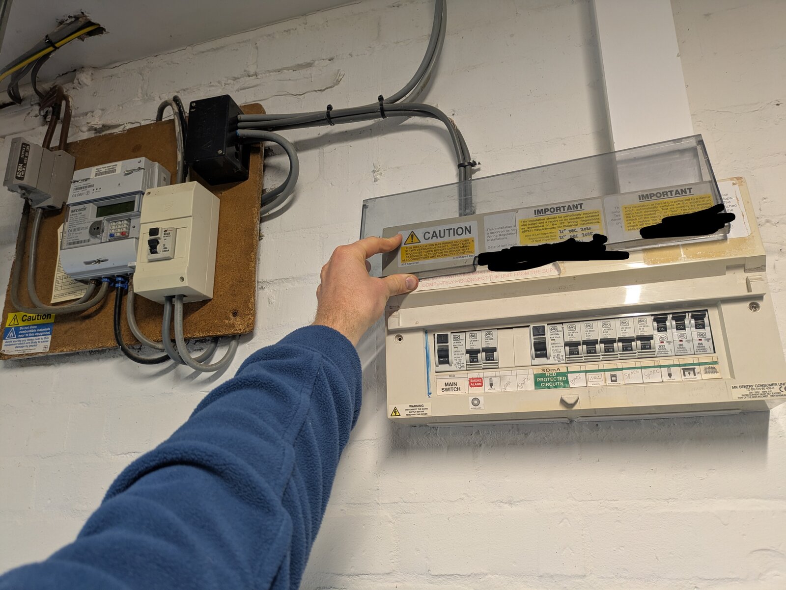

Garage setup - Incoming supply, meter, big switch and small consumer unit for garage circuits (which includes a small utility area).

Zero chance of anyone else touching it. No one else has been here, kids are too young to reach that far up, the dog likewise and the wife absolutely wouldn't touch it with a barge pole.

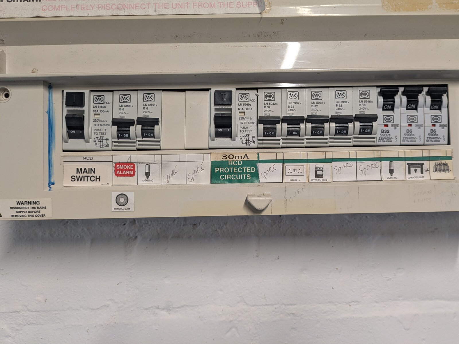

What is puzzling me the main breaker is 100ma, but the CU with 2 far more sensitive RCD's are not tripping. Something not right there.
Ah-ha! One of the CU's RCD's is rated at 100ma, so that one is probably not quite as sensitive as the main one. The problem most probably lies within the section served by that 63a 100ma RCD(y)
I am now confused, two different consumer units, and a 100 mA RCD fed from a 100 mA RCD, so previous comments clearly wrong.

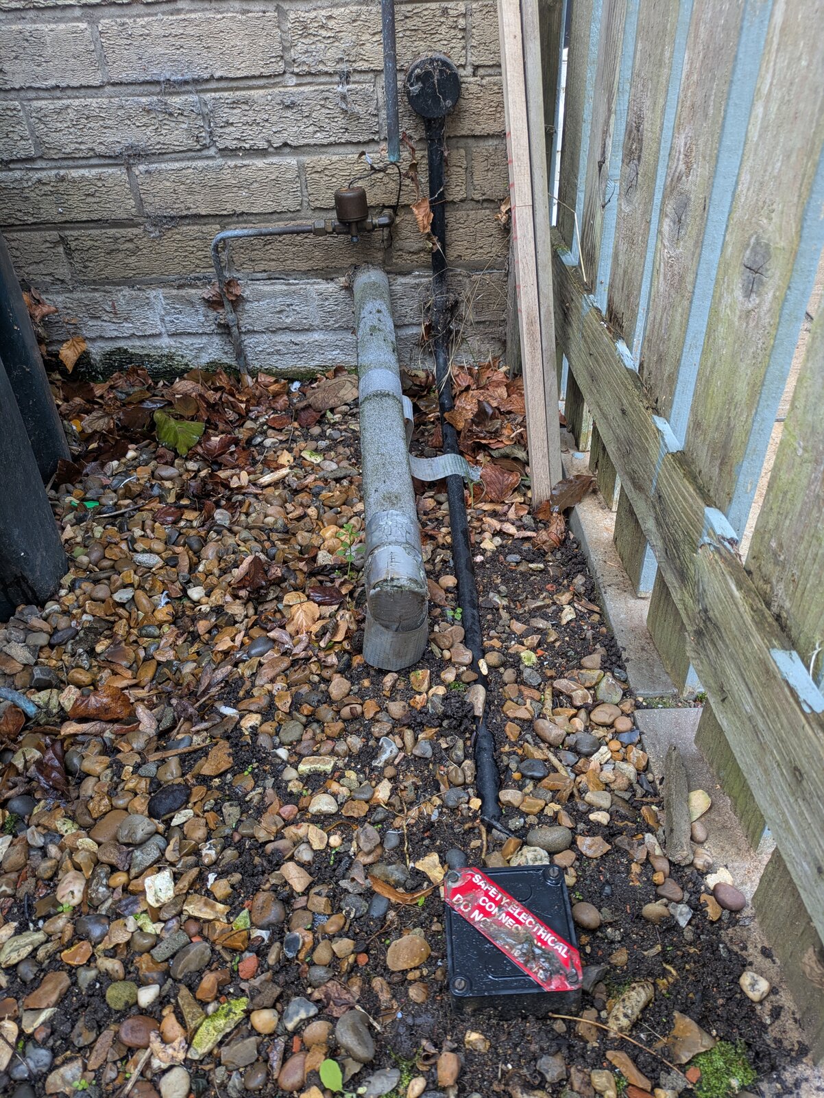

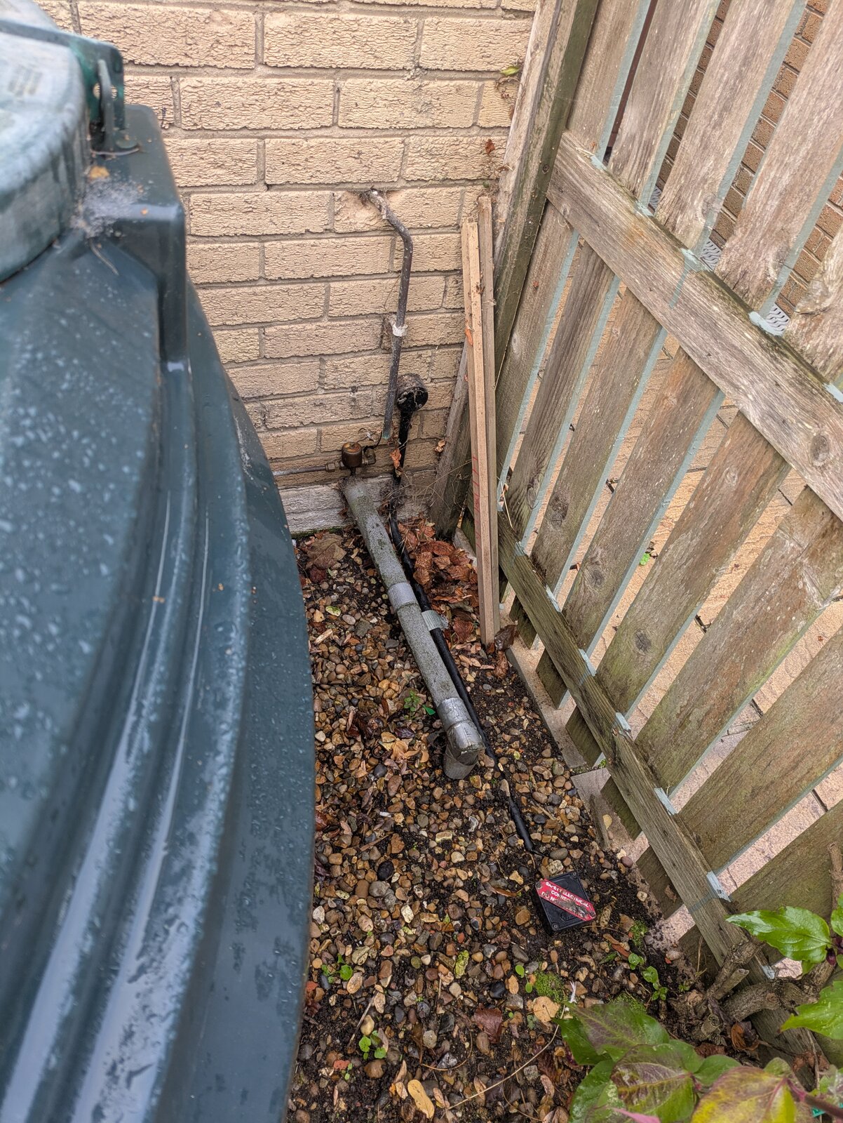

It seems I do have an earth rod (bottom right of these pictures). Hadn't paid any attention to it before.
This is located behind the garage by the oil tank. I can travel the cables back to the main earth lead identifed next to the meter (that EricMarc above took them snippet photo of), but it goes in generally the right direction before disappearing into the flooring.
Would you expect just one of these (and not another near the boiler - in which case I've not located a 'main' one)?
