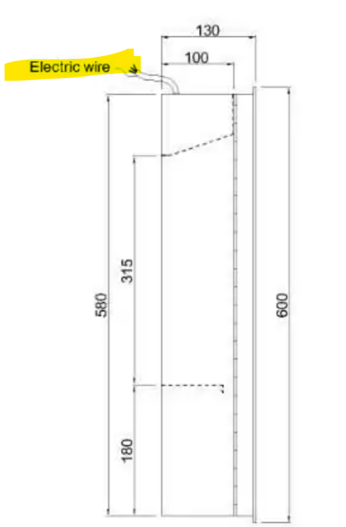

Have just taken delivery of an IP44 rated bathroom cabinet with LED/demister. The back is completely flat, no void, and as you can see from the spec diagram, the cable comes out of the top. The electrician is going to run a power cable to the area but I'm scratching my head as to how the two will be connected. All I can think of is a flex outlet plate directly above the cabinet which is going to look unsightly. (It's a black cable too and of course the wall is going to be white.) Any ideas?!

Edit, oh your wire comes from the top that's even worse, I'd make it back entry and blank off the original hole.
Our one originally came out of the top. All the connections are in a concealed section at the top of the cabinet. When I worked out it's position, I drilled a hole in the back near the top, chased the wall out and run a 1mm t&e cable from the loft, connected it up inside at the cabinet end and into the lighting circuit at the other end. Probably wrong as there’s no separate isolator to it, you’d have to turn the upstairs light circuit off if you were ever working on it (I left a note inside saying so) but it’s been fine for the best part of 20 years.

The electrics are in the top part of the cabinet - can see the screws so probably accessible.

I only have retailer photos right now. I didn't see this before I bought it! It's got a cable entry grommet

It will go in a small ensuite and the left side of the cabinet could be within 60cm of an extended shower head (but not when in its cradle). Wouldn't that make it Zone 2?
Find a small polished s/s box, discard the lid, drill one side to take the cable, fix it to the top of the mirror so that it covers the cable and the flex outlet?
