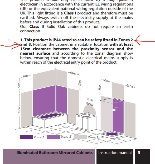

must be quite an old product/ out dated manual: mentioning zone 3 (when was zone 3 scrapped?) and most things bathroom related now mention RCD supply
The instruction manual makes no mention of zone 3. It shows zone 0, zone 1 and the "mysterious" zone 2 around a basin (that was discussed to death on one of my other threads http://www.diynot.com/diy/threads/bathroom-zone-2-above-a-shower-cubicle.439978/)
Edit: Just had another read of the instruction manual, and it does mention zone 3 in the text, but the diagrams only show zones 0,1 and 2.
Dave - it is in the text mate, not the diagram:
