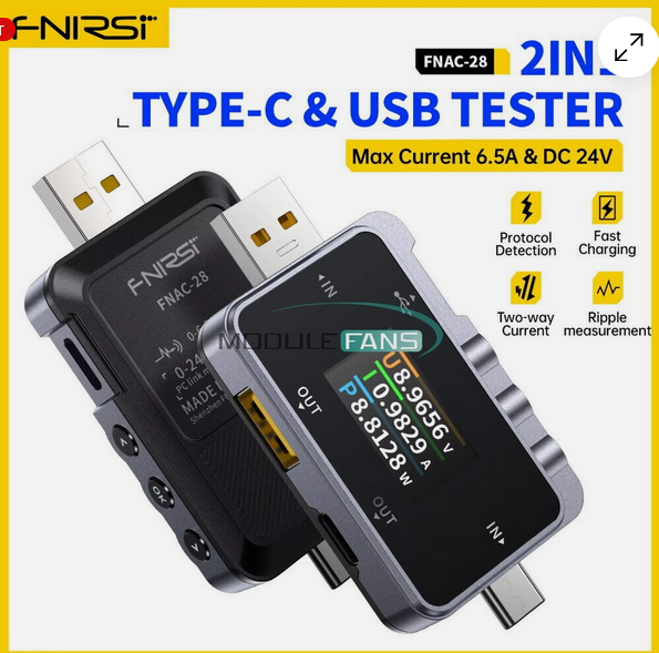

So surely the below devices must have some 'charging' circuitry, and on my laptop I have different standards of USB - which from what I understand have different load capacities ... I have one of these I should use, think that can tell me the current drawn and supplied between device and charger ...

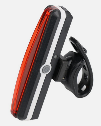

The headphones and bike light simply came just with a USB cable - no charger, this is my light below, rated 5v 1.0a:

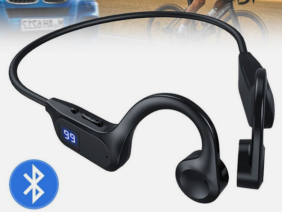

The headphones (these are similar - but not the exact ones), are the same, no charger, just a USB cable:

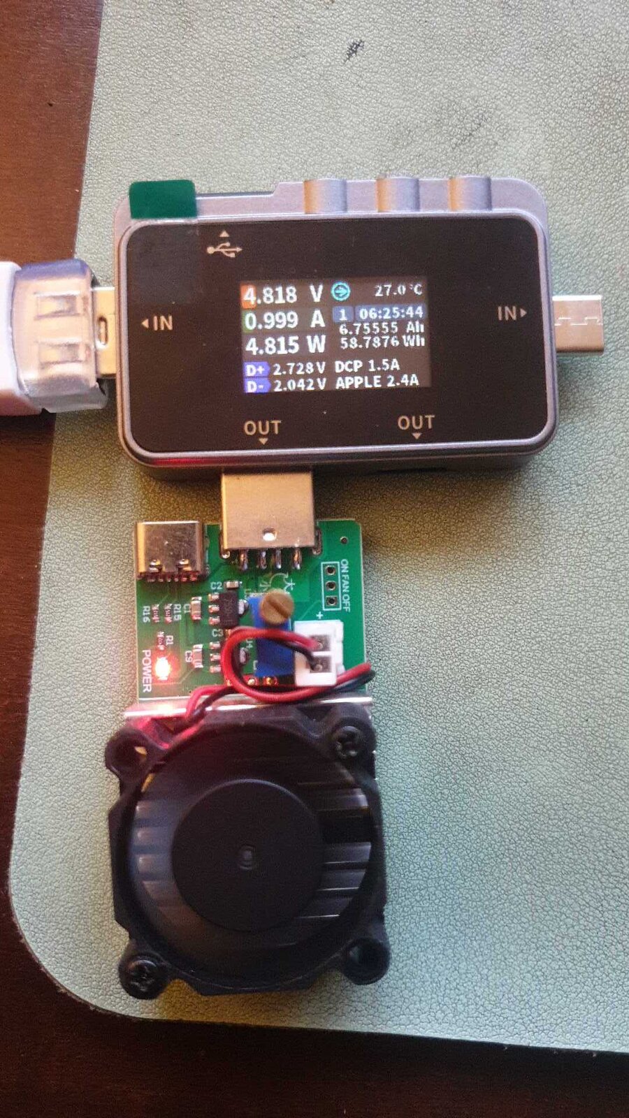

Load tested the 'charger', and it cut out at about 1.2a:

OK, so I tried testing the headphones:
.. but I think the batteries are stuffed, so cant get any good readings, ie its not taking any curent (0.018a 0.086w @ 5.12v)
I had up till I stuffed the batteries (by charging with the Ikea charger) been charging it on my laptop ... so @ericmark - could one assume the headphones are only designed to be charged on a Laptop USB port ??, and the output from the Ikea charger is greater than the USB ports on my laptop ?, my laptop US port spec is:
