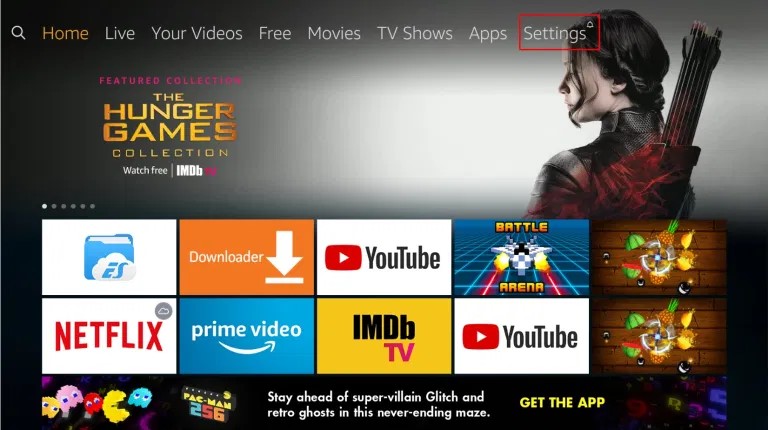

Converting HDMI to SCART is not going to end well. For a start, the video chips in these cheap convertors are not great. Second, they don't output RGB video. It comes out as composite (the yellow connector equivalent), and that's about as low as it's possible to get on the hierarchy of video picture quality.
Your picture from the Fire TV / Roku will start like this if you had a HDMI connection...
but by the time the convertor has mangled it you'll be lucky to get this...
You can't make a silk purse from a sow's ear. These convertors are sow's ears. Save yourself a whole load of hassle and just borrow a TV with a HDMI input.
