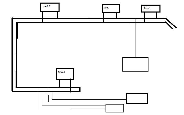

is it possible? with only a control valve and LSV? if so how? cheers
The more the valve is closed, the less water goes through the valve. Most of the water will rush past the valve along the 15mm or 22mm pipe.it may end up noisy as the water rushes through the LS valve.
its a rubbish pipe setup me thinks, done on the cheap when the house was built i would imagine
Could it have been a one-pipe converted to two pipe?its a rubbish pipe setup me thinks, done on the cheap when the house was built i would imagine
At the risk of confusing the OP! I did find a website which said that the flow and return should be joined - but nobody else agrees.moggett said:In a two pipe heating circuit, there should be no connection between flow and return other than through the radiators or a bypass valve. The flow and return shouldn't be joined!
