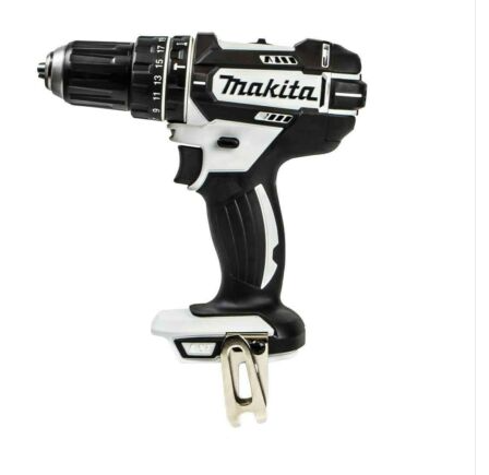

I have owned one of these for the last 3 years but not used too extensively. Unfortunately, it's developed a fault where the trigger button sticks when fully pressed. It either needs to be pulled out or most commonly, I remove the battery to bring it to a halt
Can someone please suggest a fix?
Thanks in advance.

I'd start with some silicone spray. Often frees up these sort of things. Easy to try and won't hurt. After that you are into opening it up. The switch can buy bought separately and is pretty easy to replace if all else fails. They can be little fiddly to put back together without pinching a wire but its an easy diy job.

I've since had a scour of the net and Youtube and it appears that I need part number 650731-7 and this costs around £30. It seems reasonably straight forward to replace.
However, is this a good choice of action given that a new drill seems to cost £43.99

Thanks again @nickjb. Can I squirt this through the voids next to the button? i.e. without opening the unit
Also, can I use 3-in-1 oil as I have that in the shed?
Just squirt it in. It's much better than 3 in 1 for this. It'll penetrate better and with oil based lube you risk swelling anything plastic (only a tiny bit but that obviously won't help in this case) and it'll eventually pick up dirt and form a gummy mess. Silicone spray should just put a very light slippy surface on it. Its pretty readily available in Wilkos and often other Bargain World type shops, or screwfix as I linked to.

Makita have said they will repair this as part of my warranty. I didn't ask too many additional questions!
It's going back tomorrow for some TLC :)

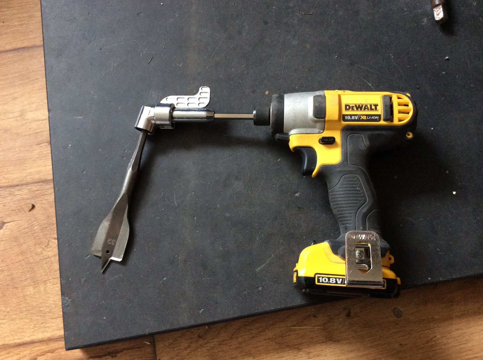

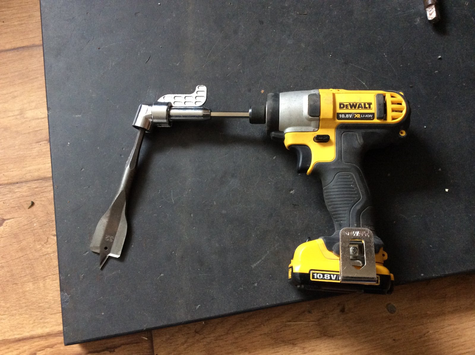

In the meantime, I need to punch some holes in joists to pass cables (would have used the spade connectors on my combi drill). Can I use my Bosch SDS or impact Driver in some creative way to accomplish this please?
