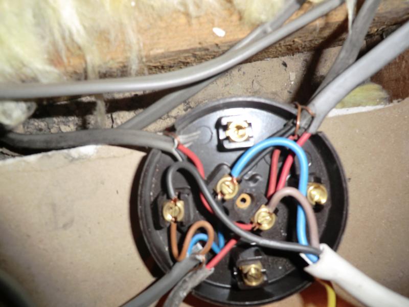

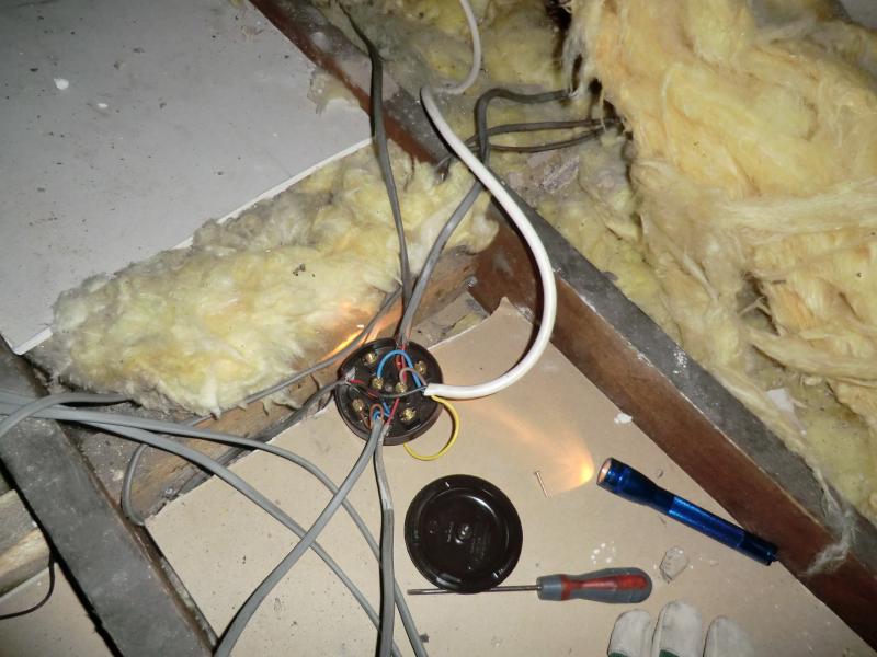

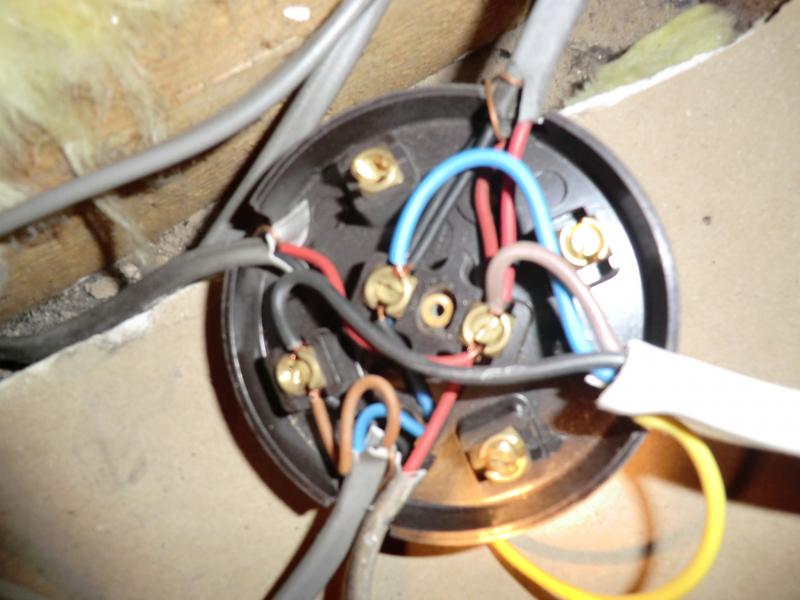

Or, do you know where the other end of that cable comes from? Can you take a picture of the other end and post it on here? (not the end at the fan!)

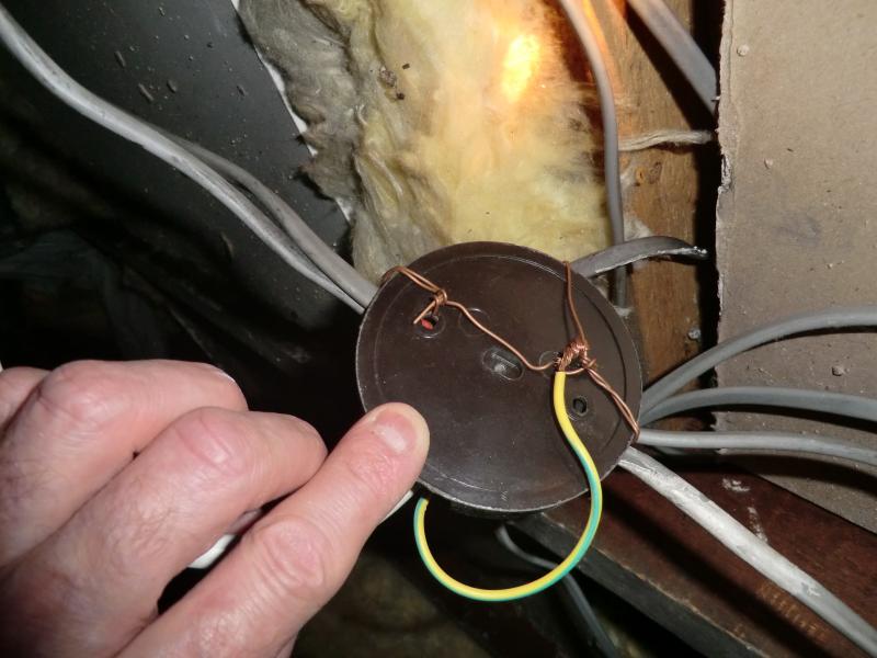

Right, here are some pics of my fan wiring connections .
The white cable is the supply to the fan, bare wires off the other cables are joined to the fan supply yellow wire underneath the unit as shown.
Hope this helps.
OK
So in that box, thw wire that is blue is actually grey, with a blue sleeve over it. so in your fan, the grey is the neutral. It should be sleeved blue at the fan end to show that it is the neutral.
Brown is perm live
black is switched live. It should have a brown sleeve on that wire at both ends to show that it is a conductor that can become live.
Those earth wires should not be twisted and terminated outside the box.
There are spare terminals in the box, use them to join together all of the earth wires, These should be sleeved green & Yellow.
