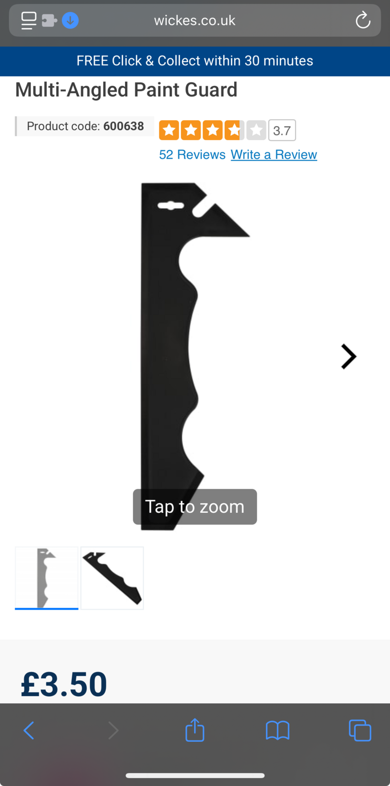

Masking doesn't have to be done with tape. You can get long, washable, blades that you hold against the painted surface with one hand while you paint the other, then move along when you're done:
When using one, recommend not to overload your brush with paint, and when lifting it away from the work to move to the next spot, do so without sliding it across either surface (if any paint has pooled up on the edge it will drag it across the surface)
Keep the edge clean as you go

The wall has been plastered and was going to do a mist cost using a spray gun so don't know how well the suggested paint guard will work.

Given that you probably wouldn't do a skirting board with a spray gun, how about spraying the whole wall, not worrying about the skirting, then use a masking blade for when you paint the skirting with a brush, painting over then overspray?
All that said, I use a paint guard blade when I'm painting with a sprayer (Wagner airless). It's a custom thing I fashioned myself out of an aluminium underfloor heating tray about a metre long, but it could easily be smaller and still usable; the sprayer is pretty direct
