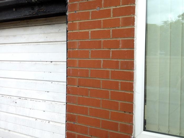

Here's the wall I just stripped of paint

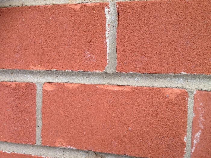

Here's a close-up of the typical damage

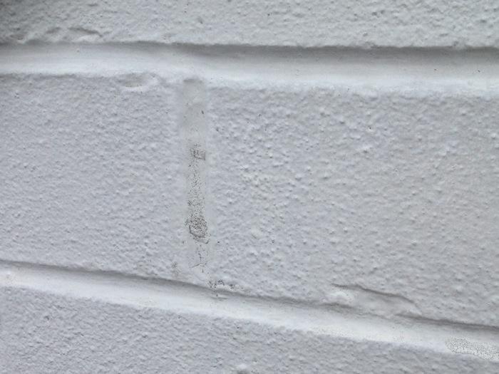

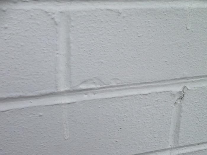

A couple of pictures of one wall yet to be stripped - with damage lying beneath the paint
The edges of the bricks are chipped, not a lot can be done leave them to weather and the edges will darken down.
The other alternative is to paint the brickwork !
Looks 100% better than it did painted despite the chips. I'd just leave it and forget it. :)
Hmmm - I'm pretty unhappy with how it looks :(
The chimney is built from the same bricks - and two of them have the faces completely blown off. Considering the bungalow is only 34 years old - I suspect these are just crap quality bricks. My worry is that now I am stripping the paint off - they will continue to deteriorate :cry:
It wouldn't look so bad if the bricks were multi facing bricks which would disguise the chips. Them being a solid colour makes it all the more obvious.

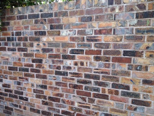

They actually cover just one elevation of the house - the other elevations being incorporated into what was an existing building dating from the '20s. Those are traditional multi bricks which look much more appealing.

Here is what the other walls look like for the original older structure - and form the remaining three elevations - quite a contrast!

The newer bricks are clearly nothing like the older ones, so I agree it's a poor match and would possibly annoy me, especially if you see the two designs together.
