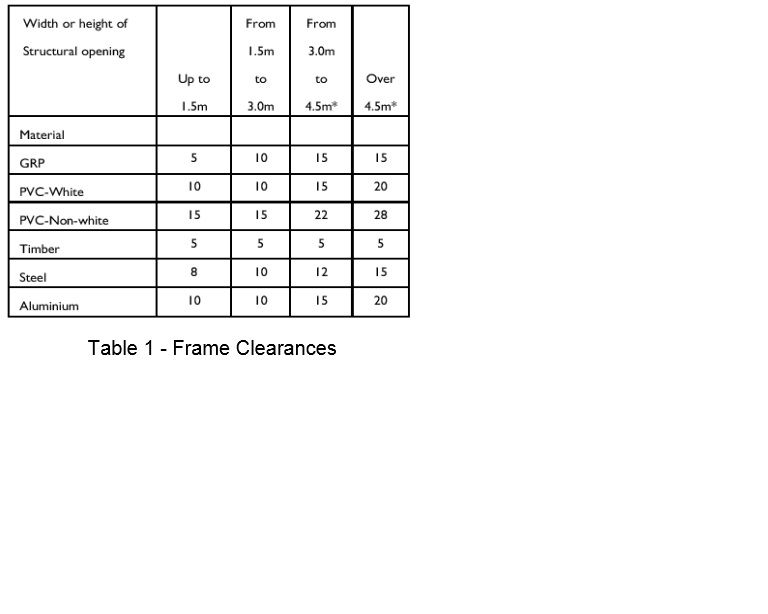

Someone was asking about expansion and frame deductions a while ago, I cant find the thread but I just found this again:
Best bone up on it guys as it will be in the MTC test. Also I had my Fensa transition inspection today and the guy said there is a trick question on the test about the max weight we are allowed to lift. He said the correct answer is 0??????? Not the 25k you would expect it to be.
