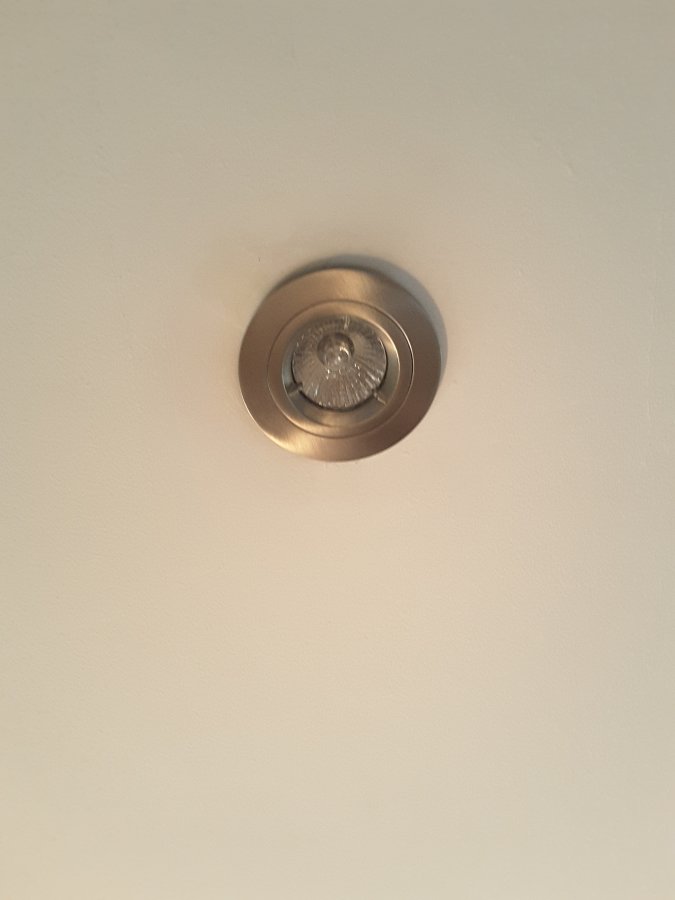

Both circuits are controlled by the same physical dimmer (it has two dimmer knobs). One currently has 1 incandescent e27 on it and the other has eight 35 watt GU10 halogen downlights.
I am going to order the one e27 led dimmable and see if it works in the circuit. For the others, I have the pictured fittings. Or those mr16? I don't know.
In any case, if I were to go full LED, I have to alter these, or is the switch the only thing I have to alter?

It depends on the dimmer. The load requirements are usually written on the back.
The back? I just pulled the plate off and there was nothing written there, so I assume you mean on the back of the entire dimmer (i.e. I need to unscrew it out). I am big scaredy cat when it comes to things like this.
I have read that the best way to figure this out is to just try the bulb as it if it doesn't work it won't damage the bulb or the circuit..
