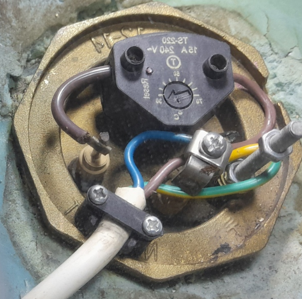

I had a problem, so looked up the part number of the thermostat, a TS-220 1695658910102.png sorry for mirror image, and on looking it says 7 inches long, but my tank must be near to 4 foot tall, so it is only measuring the temperature of a small amount of the tank. The reset had popped and the temperature was set too high, so lowered temperature and reset.
The iboost+ then started to heat my water at nearly full output, but not for long, very soon it said
which basic means the thermostat has turned off and so immersion is open circuit, if there is no spare power it says
then I found the iboost+ turning on again latter and it said something like
not the full 3 kW but some lower amount, I assume the water has been moved in the tank allowing it to re-start heating it, not sure if the lower amount due to how much solar available or if there is some software which tell iboost+ to reduce how much it heats if it was on not long before?
However I am not sure how an immersion heats the tank, OK read about the Irish Willis system, but don't think I could trust a Welsh plumber to fit that, I have a simple immersion in the top of tank, and a hot coil further down, so how does the immersion heat the tank? Does it only heat top 7 inches, or do thermals slowly move the water allowing although slowly the whole tank to be heated?

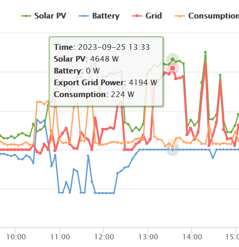

I would think the peak
is where the tank was reheating due to it having tripped before and my resetting the cutout, not sure about other peaks, it says it has used 0.70 kWh today (actually says "saved today") but when I run the central heating to heat the water it runs for around 20 minutes at 21 kW which equals 7.00 kWh not 0.70 kWh, OK some losses in the pipe work, but we are looking at 10 times the energy used.
So what is going on? Has it been for the last 4 years since moving hear I have been using too much energy to keep water warm?

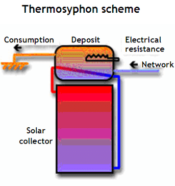

As said Willis is answer, but not sure how much water circulates in a cistern? Does is slowly work its way down, I know water most dense at 4ºC so at the bottom of any large mass of water it is 4ºC, but there must be other factors, the water entering and leaving must cause some movement, pictures show a gradual change in temperature 1695677426701.pngstratification is not as a hard dividing layer, I think the name for the layer of mixture is called thermocline, but how much can heat in water move by conduction? Even if that conduction is the copper wall.
I would have thought a element in the centre would cause the centre water to rise, cool slightly from the sides of the cylinder and then drop down the outside.
However the question is how much, and does the about of lets call is stirring of the water vary with the amount of energy put into the water. If the water is heated with 250 watt or 2500 watt what amount of water will they both heat?

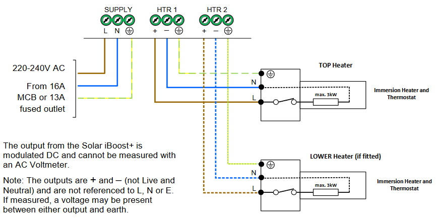

Immersion is at the top, I remember at one point you could get twin immersions one long and one short, and one could select bath or sink, the iboost+ installation manual does show two immersion heaters as an option 1695681236571.png but states one immersion is more popular. Can't see how one could fit two unless tank designed for it, but with cold water this morning, and 7.9 kWh exported it has only used 0.7 kWh of power to heat the water, this explains why the water did not stop hot very long.

In that case, it wil never heat more than a small amount of water - water below the immersion will never get appreciably heated, because the thermostat at the top will switch off the element as soon as the water at the top is 'up to temp'.

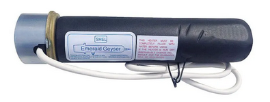

I remember at one point you could get twin immersions one long and one short, ...
One still can. For example ...
.... Can't see how one could fit two unless tank designed for it, ...
All of my DHW cylinders are 'designed for it' - with provision for one ('long') immersion inserted into the top, and another near the bottom on one side. These days, it seems more common to have just the top position available, but with the possibility of using a 'dual' element one, as above.
If the reset has operated, the thermostat has failed and will need to be replaced.
If you only have a short heater in there, get a longer one installed which will heat most of the cylinder rather than a tiny section at the top.
'DC components' created by an immersion heater element ??
Solar iboost installer manual said:
The output from the Solar iBoost+ is modulated DC and cannot be measured with an AC Voltmeter.
The question is do I get another immersion heater installed? I will pick up a new thermostat next time in town, as @flameport says if failed once may fail again even if temperature now turned down a bit. Until solar fitted the immersion was for emergency only, so never really used.
But not withdrawn the thermostat and tested, possible the pocket is longer, and wrong one fitted? Which is why I started the thread, if the immersion is longer than the thermostat then it can heat water lower down over the temperature of the cut out before the thermostat turns off, so could trip the cut out due to wrong one being fitted or could it?
