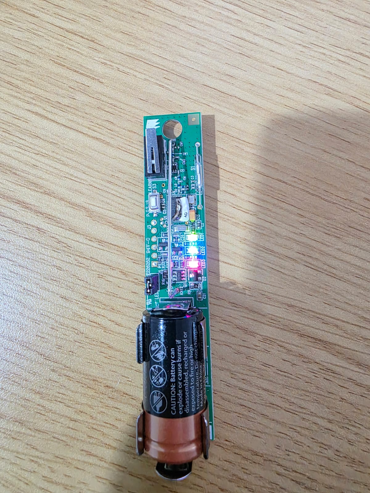

Hi All, While replacing the battery on MC1MINI-WE Door Sensor on Pyronix unit, I've placed the battery in incorrect way and realised it after 15 mins.
The unit is heated, now when i place the battery in the right direction, all 3 LEDs flash. Red, Blue and Green. Does that mean the unit is broken? is there any option for reset ?

Remove the battery and leave it out for a bit then put it in the right way. See if you can relearn the input.
If all that fails then you’ve fried the board by reversing the polarities.
Thanks for your reply, I will try this option, if it doesn't work, I will order replacement, if you know how to reset the main enforcer please let me know please... Thanks a lot for your valuable time given to reply...
I mean if i replace one door sensor with new sensor, does the enforcer recognise the new one?
You will need to delete the old input and relearn the new one. You’ll need the panel engineering code to be able to do this.
Ok, i read in some articles that engineering code is 1111 but let me see if my old documentation has any code written during installation
If it was installed by a firm they will more than likely have changed the code from its default. If they have it will be easier to contact them for the information.
