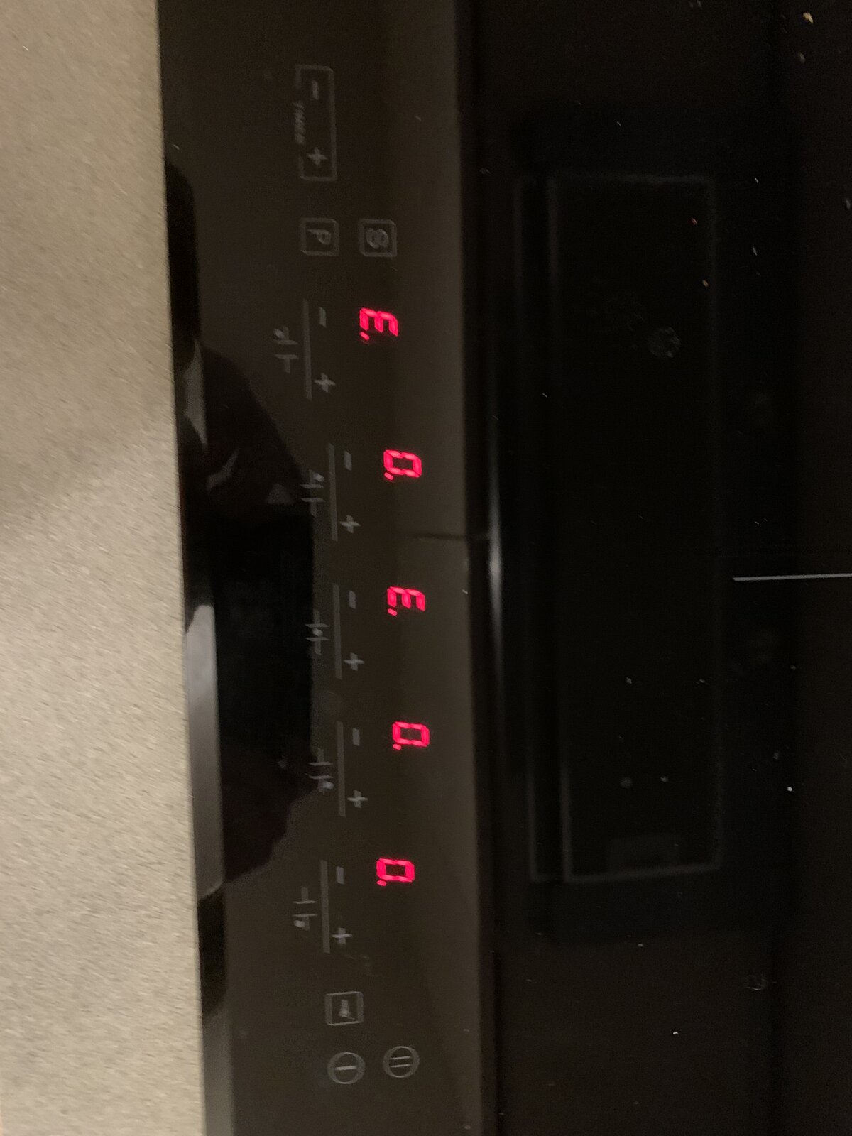

I turned out that there is a problem with my induction hob. Error code E6 on 2 burners. Anyone has an idea what it is, how to fix it, or how much to get it fixed? There is only one burner working. I am wondering if I should use the working burner before an engineer could visit.
My induction hob required a dedicated 32A supply. Is yours just on the same circuit at the rest of the kitchen?
MCB is B32. It is sharing btw fan, refrigerator, microwave, dryer, induction hob and washing machine, maybe dishwasher. It sounds too much. My SMEG hob model is SI5952B. I will never dry my cloth when cooking:(
I assume your hob supply cable has a plug on it ,that is plugged into a socket,which is on a ring final circuit ? And the hob has a fault that's tripping the MCB.
Not so sure, @terryplumb . Moving in for 5 years, and something is still mysterious to me. The Hob has a fault now. - Showing error E6. But can I use the others burner before an engineer can visit.
Cannot find any help during Xmas & new year holiday :( I really don’t need 5 zones. I can only manage 2 at a time. It is so expensive to replace, but it is built in kitchen, what can I do? ALas!

If they heat up without tripping a breaker then you could use them. If the hob trips a breaker ,then obviously you can't.
