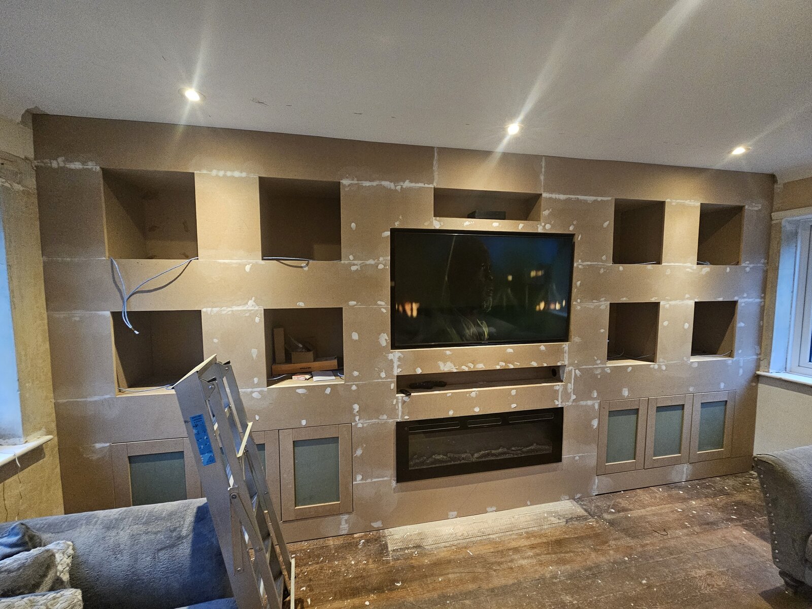

Hi all
I have a large MDF unit to paint in the front room.
Shown in the picture below
Just after recommendations on paint for toughness
I will probably use zinzzer bulls eye as the primer/undercoat
So any tips or recommendations on hard wearing top coat
Thaks all
I'm going for run of the mill Dulux Satinwood on my built in Ikea/MDF shelving unit. Though the pros may suggest something else.
Zinsser Bullseye 1.2.3+ is what we use and depending on your colour choice get it tinted if a dark top coats being used.
Paint Depends on sheen level but can't go Wrong with Tikkurilla's products and to finish it off if its prone to get knocks etc topcoat of polyvine varnish for the added protection.
