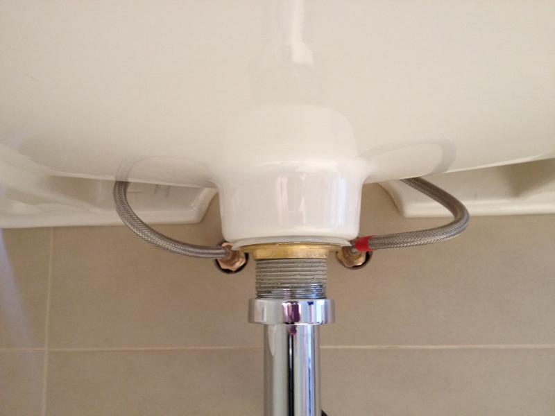

Thought softener was meant to reduce limescale? Was asking as I read water softeners can reduce pressure. We have an H2 Options smart meter. Attached is picture of debris engineer found when she opened hand held shower.
It is a new bathroom, attached picture of the hoses under the sink (which now cross over, in order to get hot and cold the right way around!) Although this wouldn't explain low pressure/flow in shower.
Plumber could get into the shower heads but not the sink tap.[/img]
Okay not sure my photos are appearing ..? Got them in my album how do I attach to a post ..?[/img]
Some basins don't have filters, stone have them, bizarrely too late - in the spout. Others have them integral with the cartridge.
Impossible to say from your pics.
Sinks flexi's look OK there, but doesn't eliminate the problem being further upstream.
