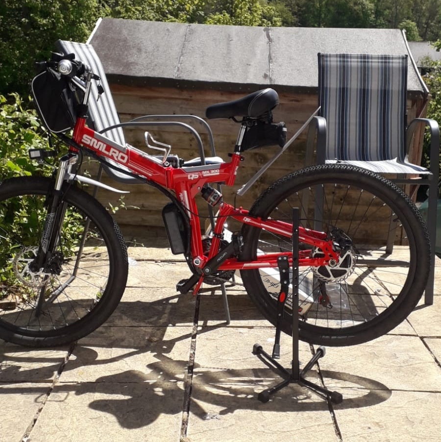

Anyone got any experience bodging up e-bikes with BLDC hub motor at subsystem level?
I have developed some broad theories on the arrangements so far, based on my vast experience of :
guessing a diagnosis of failed and unidentifiable controller on one problem bike, taking a punt on something with similar power/voltage rating on ebay, getting it home and bodging it in. these are my thoughts:
where I refer to things like "usually" this is informed solely by amazon/ebay windowshopping.
I contend that A, B, D, & F are very likely to be functionally compatible between all products, therefore you CAN use any controller to make a hub motor drive with proportional throttle control ergo, a working ebike.
I further contend that refinements (E,G) such as pedal assist and operational display & keys are less compatible between components.
would welcome comments from other experiences

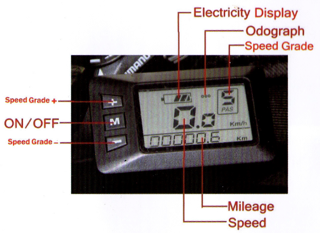

G. Display (not essential) ..... usually comprises of a LCD and 3 keys.... but limited standardisation of wiring and possibly not all displays are compatible with all controllers? I note RxD & TxD on my failed controller, associated with the display cable, so probably some serial data arrangement which could have differing protocol nuances between mfgs - although this seems unlikely because all handlebar arrangements are very similar ( 3 keys UP/DOWN/ONOFF + similar display data) Anyway, I couldnt get the bike's original display to work properly with the replacement controller.
I think I am missing something, possibly a Controller Module Enable line, because I noted that whilst I couldnt get the display to work properly, I couldnt get any motor response if I didn't have certain display lines connected, but couldnt work out what was going on. I did not have to have the display lit-up for the motor to drive.
The display & switches appear to offer the possibility of:
monitoring energy remaining. this is a pretty desirable function tbh. (which is only thru simple voltage measurement of battery+ve line which is used for powering the display).
power ranges (1-7). I deem this is an unnecessary frill
odomter / speed (unnecessary frill)
pedal assist or non-assist modes?
Anyway it was all going reasonably well with my £20 replacement generic controller (could get proportional drive to the hub motor anyway) until I accidentally placed it down onto a piece of solder and now it's dead.
After the swearing had died down I condensed my waffling views above into this:
you can make any similar controller drive a BLDC hub with any throttle, but if you want a decent repair with operating display/keys etc, then you should get a controller with its compatible handlebar display. so now Ive ordered a controller with a display kit for £35.
