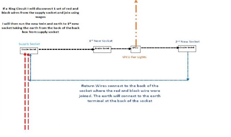

Ok. I can see that may be possible on part of the route.
Otherwise, agree with Daniel.
But then, could be an older version of that's how we've always done it.
Here is what I would like to do, I hope it is clear enough to see what I am looking for

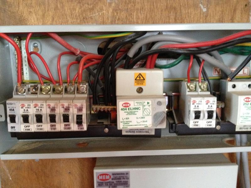

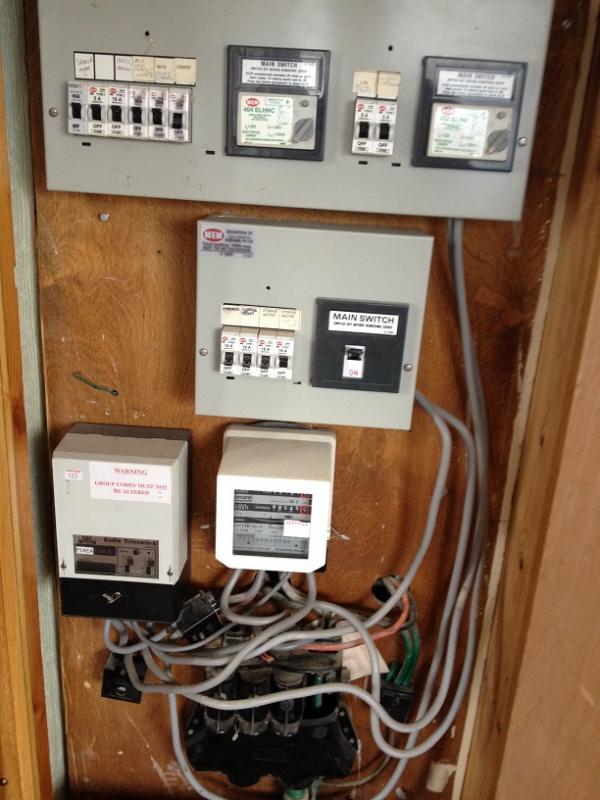

Just one thing with the consumer unit.
Be aware that the two RCCB/Main switches are separate and will both have to be switched off to isolate everything in the house.
Thanks EFLI
Are you saying my plan looks ok to do
I will double check it is a ring main
I will also make sure the efl is ok before proceeding.

Yeh always do switch both of them off before doing anything electrical, I even hit the mane switch
