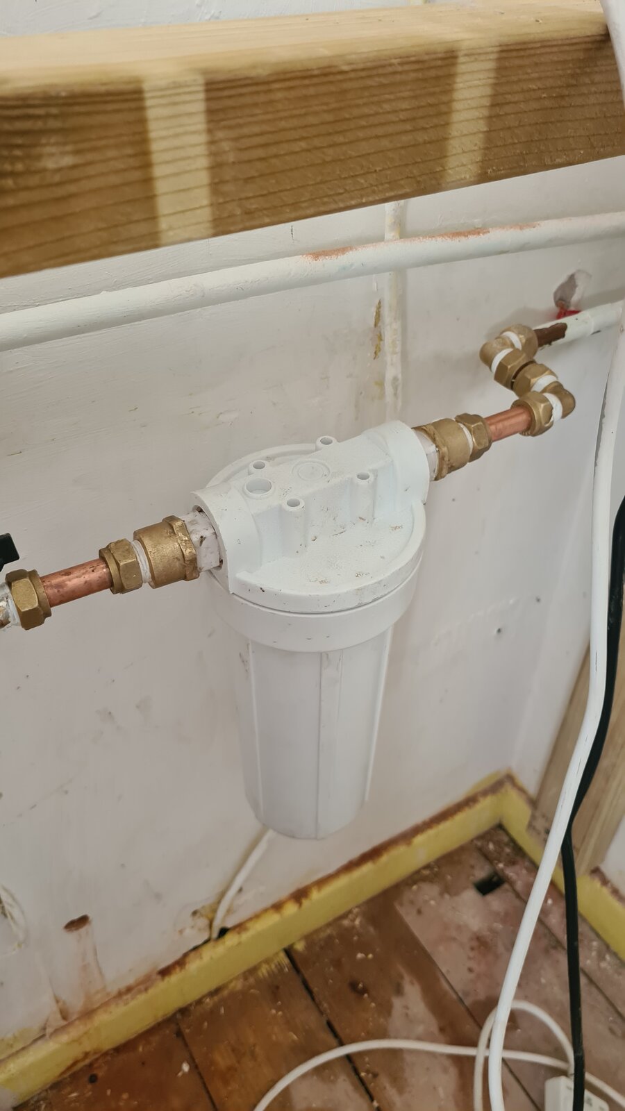

Hi
Didn't realise an old water filter was hidden until room was ripped out. The old filter was not nice to say the least
Bought a kit like screwfix one and the adapters which were recommended .
Its all be compression fitted by previous owner as he was a handy man so I decided to get near enough same style filter to swap
Stuck on the 3/4" to 15mm adapters but they weep as its copper to a plastic thread which then screws into the filter.
I have fitted alot of Ppte tape and the in side okay but the out side weeps. Is there something better to use that ptfe
Loctite 55 is a good alternative.
And remove all of the PTFE from the threads of the compression fittings. It is not required and looks like a bodge.
Too much ptfe tape with too much force can cause the plastic to split and leak so don`t go all gorilla on it. If you really struggle then a light smear of lsx on the tape will help.
