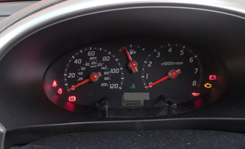

I am looking at a slow fuel tank air leak due to corrosion of the filler neck around the cap area. This caused the petrol to evaporate over the course of a few months. So far this hasn't caused anything to light up on the dash. According to some reports on the internet, the corrosion is an MOT fail. But, I have never seen a tester looking at the fill opening. Does the fail only apply when an indicator is shown on the dash? How do I assess how bad the leak is, perhaps with some kind of pressure measuring device? Would it be cheaper to buy a new neck than getting a testing device? An ebay china neck is about £35. Another possibility is for me to attempt to remove the bubbled up corrosion at the cap area. But I have no way to know afterwards if the leak is fixed.

The leak is slow enough to not produce a smell. The only evidence is petrol gone and rust bubbles at the cap area. Also dirt built up on paint around the filler door in a large patch. There should be a sensor to indicate a leak, i.e. vacuum pressure too low.

Well, a full tank of petrol gone with car not driven. That's pretty bad consumption.
Nothing nonsense about evaporating a tank of petrol. Was full last Jul.
