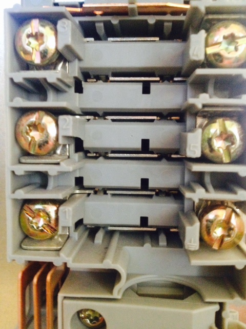

hello
Miele H383 B KAT pyrolitic 'Classic'
Can anyone tell me the wiring procedure for this oven please - see attached photo - the bottom right pin is the earth. My kitchen fitter is stumped.

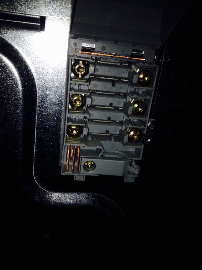

Can you post a better pic of the terminal block. I'm not 100% sure but I think you link 1 to 2 to 3 & connect live. And link 4 to 5 & connect neutral. Earth to 6. You should, as Owain says contact Miele for conformation.
Hi
better pic attached. The numbers on the poles are [hopefully visible] - from bottom left 1,2,3 and top right 4,5, earth.

Thanks.. They will not confirm wiring, it's part of their health and safety policy. What they did confirm was there's a 'special connector wire' so I bought it and had it delivered, arrived today and guess what, looks just like the one in the old oven!! Except the 3 wires on the new connector, earth live and neutral, are quite long out of the sheath and the ends are nicely tipped with a little metal crimp to aid connection and keep them tidy. It looks to my untutored eye as if the earth plugs into the bottom right pole and the live and neutral stretch across the box from one pole to the other, like a double bond BUT I don't know which one sits above the earth, and again on the top - as someone said - hard wired... someone must know, the Miele bloke said it should be obvious! Not to me or my old fitter.
Ez
I don't know how he thinks that supplying a length of cable makes it obvious why they supply copper links for the terminal block. I am thinking it is because it is made to be used on single , 2, or 3 phase supplies, hence the links. But they could equally easily be for different single phase supply voltages (transformer tappings).Do you or your kitchen fitter have a multimeter to check if there is continuity between any of the terminals on the block.
According to various manuals on the web that are findable, that's the way (some) other Miele hobs are wired.
Perhaps they're fairly standard across their ranges?
