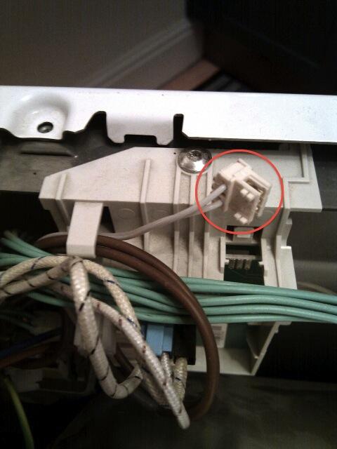

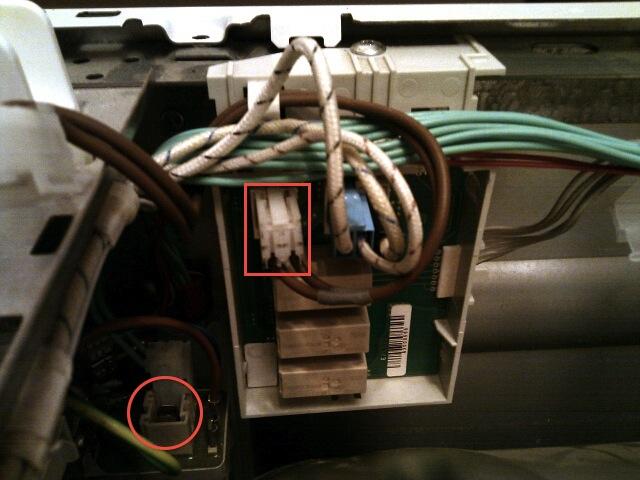

Hey zipper, glad to receive your reply! Yes, we gave it a go just now, and the rear NTC does not seem to register any continuity in the multimeter at all - reading just stayed at 1.
As the pic shows here, we tested at both points noted on the pic. I hope that is the rear NTC. We even skinned the two brown wires to test it, just in case we didn't get a correct reading.
We also tested the pale blue plug next to its right (element?), the reading was approx 94 ohm.
If you could please let us know what our next step should be, that would be really excellent. Thanks :)
Afraid you're way off the mark. The circled area marked on the photo is the mains suppressor, it has nothing to do with the NTC. The heater pcb is fed via the suppressor & it is live all the time....so I hope you pulled the plug before doing anything. The NTC plug is at the top of the heater pcb & has two thin leads attached. It is obstructed from view on the photo by the cable harness. You need to push the cables aside, locate the NTC plug & measure the resistance from there. It is all explained in the other thread.

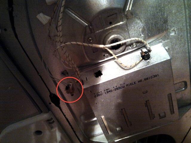

ok, I hope we got it correct this time around.
We found the rear NTC plug behind the cable harness as you've instructed :D
The one with the 2 thin grey wires, as circled in the first pic below. The resistance measured was initially 105k ohm, and as we held on to the NTC inside the diamond shaped cover at the back (as circled in the second pic), its resistance dropped to about 71k ohm.
Whilst at it, we also checked the stat at the back (next to NTC) and resistance was 0.
Hope this is the info you need.
Thanks again for your help so far!!
When the "drying LED" flashes twice in service mode it indicates an open circuit NTC on the heater bank. When no heat is registered within 1min of the heater being switched on an alarm is generated & the dryer goes into cooling phase before switching off. However your NTC seems to show a reasonably ball-park value at room temp. Not to say that it couldn't be faulty; it may well be too slow in resistance change or out of parameters on a temp scale. Another possibility could be that one of the relays on the heater pcb is defective. Did you try the dryer on a 30min timed cycle as described in my other post? It would be interesting to know if it runs, heats, & completes the cycle without an alarm...
