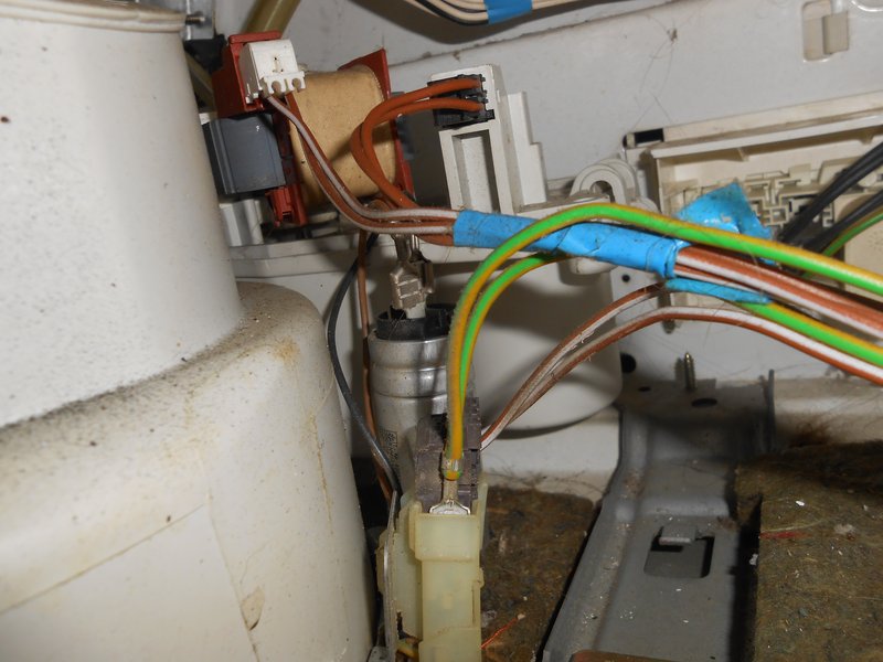

Is the water collection tray at the bottom or at the top? If at the top there must be a pump that pumps water up a tube into the water tank. Is the pump functioning? Regardless of where the empty water collection tank is located there will also be a float switch at the bottom in the water reservoir, if the float is stuck in the up position the heating element will remain switched off!
Water collection tray is at the top, I can't see if I can get to the float switch, since I have no clue what to look for ; )

Check the pump is in fact pumping water up to the collection tank. There should be an overflow return pipe, fill the bottom chamber via this return pipe then check that water is being pumped back up the filling pipe.
If the pump is working check the float switch on the bottom water chamber is operating, when full with water the switch should be open circuit, when empty the switch should be closed circuit. Usually this switch is connected to the heating circuit, switching off the heat if the water tank is full.

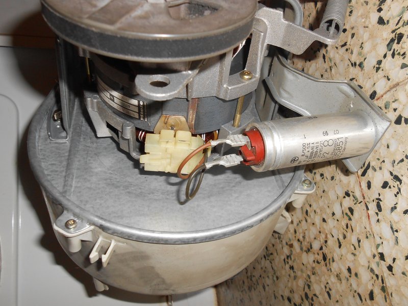

1st photo shows the pump (left rear, 2 red/white wires go into a white connector block) and the float switch (middle rear, 2 red wires go into a black connector block connected to the white water float housing).
You could remove the float switch wiring connector, short the pins with a short length of wire, turn on the dryer to see if heat is produced. If no heat still the switch is probably fine, if heat is produced then the switch is either faulty or gunked up and stuck open.

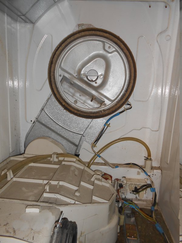

2nd photo only shows the 8uf capacitor, motor, belt and belt pulley and motor fan housing.
I am not familiar with this specific tumble dryer so more photos will be needed to identify other components. I.e heater, thermostats.
Also note that there may also be a heater relay on your model, a red squarish block located near the rear of the front fascia panel.
Checking the heating element and the cut out stat first is probably better before checking too many other things.

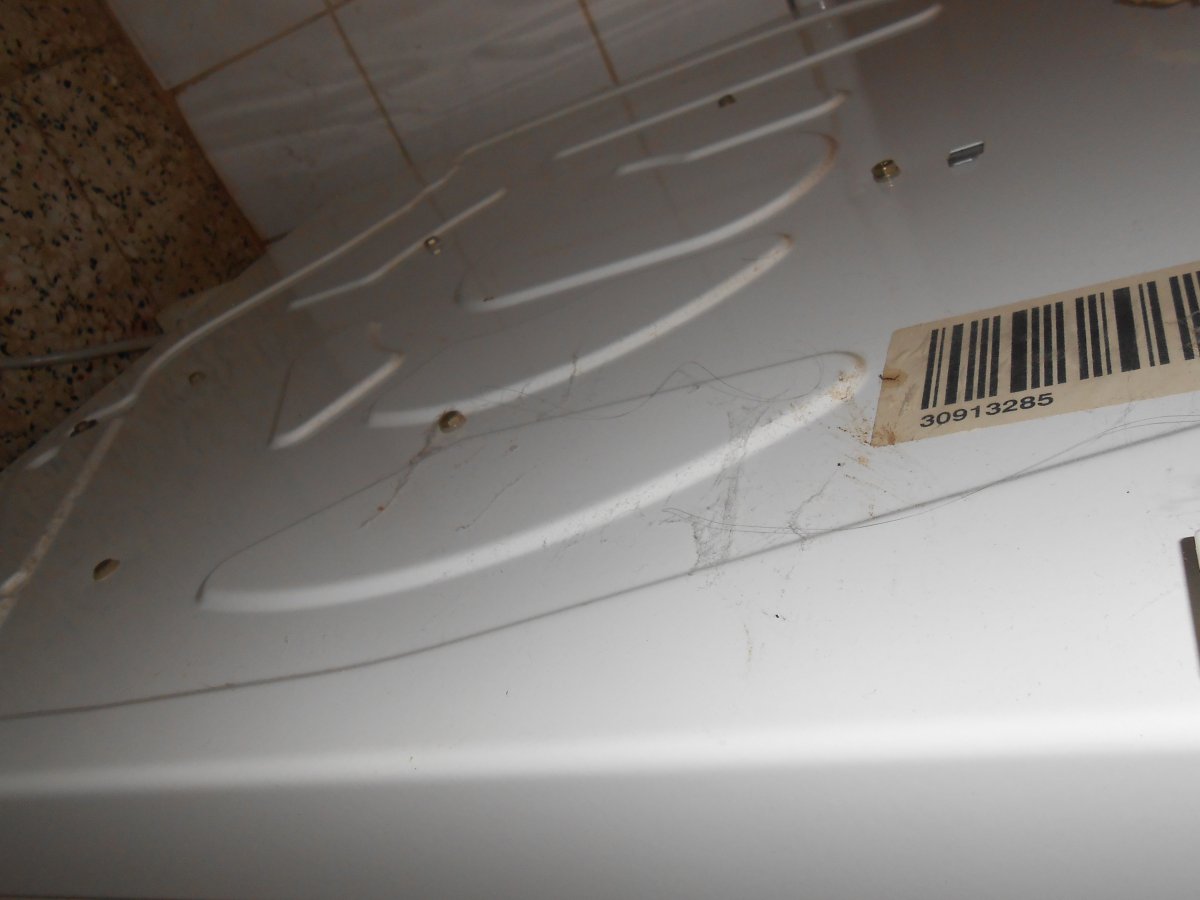

Can you provide a photo from above the dryer (looking down), with the top lid removed.

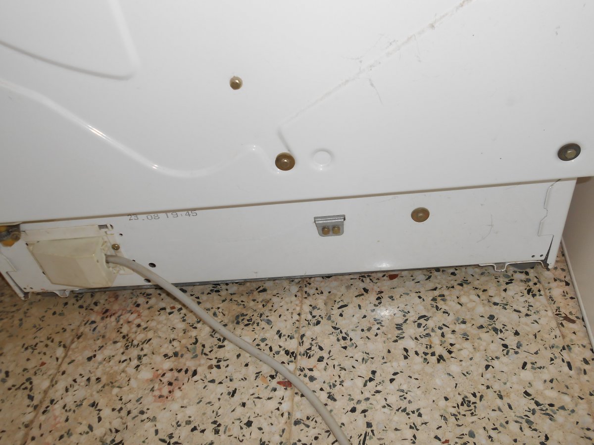

Also a photo of the rear panel.
The rear and side panel is one piece, so to get to the heater or the pump I need to remove the drum.
I just don't know how to take the drum out.

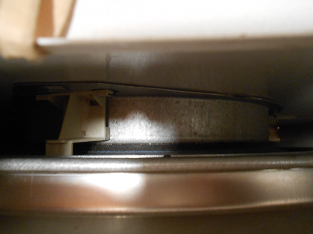

But I have removed those, I just do not know how to remove the drum, and haven't had time to jump into it yet.
I doubt anyone knows this particular model to be ableto give specific instructions.
Photo from the front?

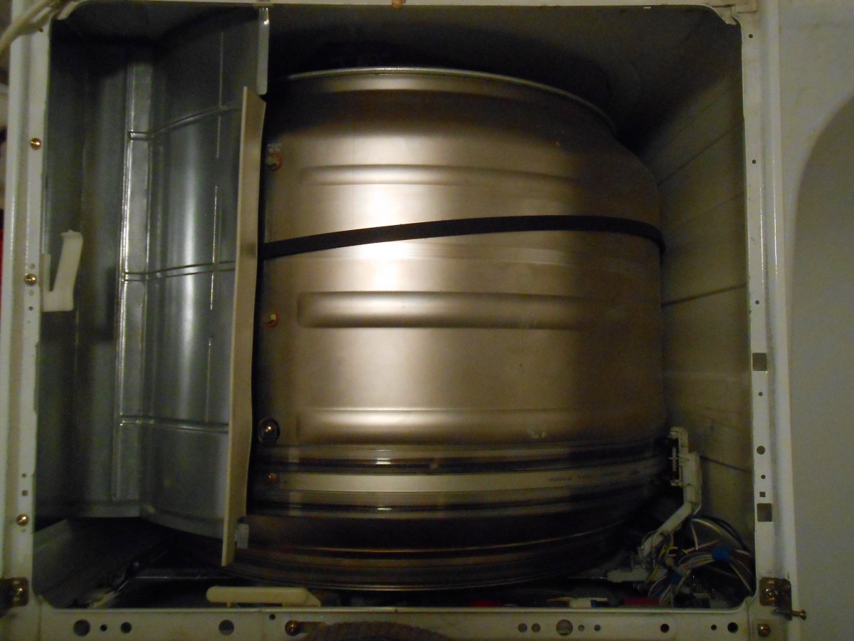

If the front panel is already removed the drum should slide out towards the front, you will need to manouvre the belt as you do it, a bit at a time. On the rear panel are 4 screws(located in the middle of the panel in a diamond pattern) , these also need to be removed to release the drum rear bearing plate/heating assembly. Also note that immediately above the top screw is a 'locating hook', this will need to be unhooked to release the assembly.

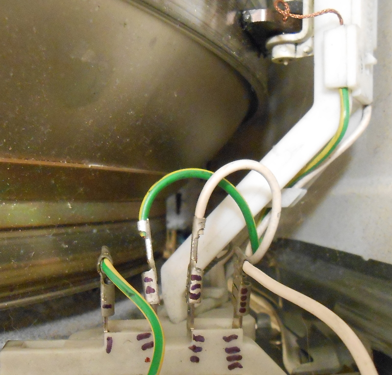

It is worth noting where cables are connected in the event you accidentally pull any off whilst pulling out the drum.

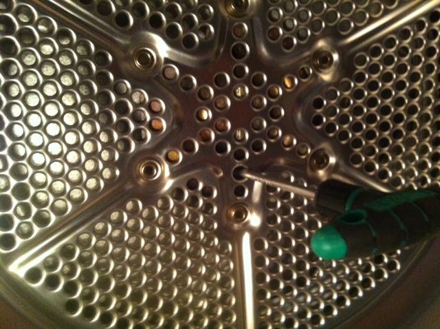

Just a thought, look inside the drum (from the front) at the back, are there any screws or are there rivets. If screws its possible this will separate the drum from the rear bearing assembly.

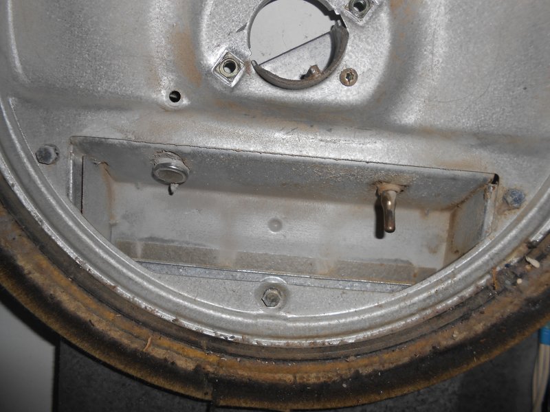

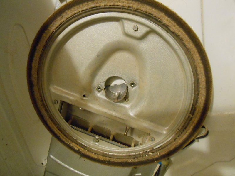

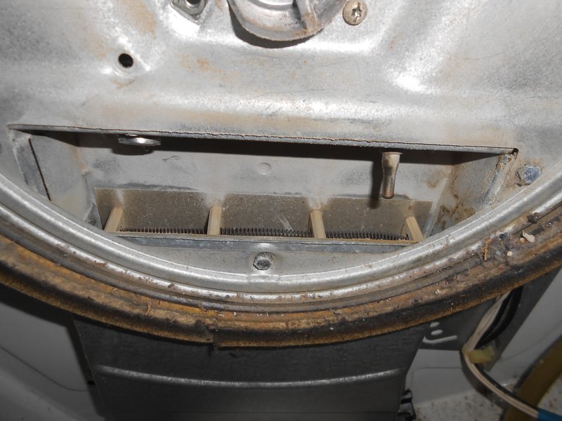

I finally had some time to take the drum out, and to my surprise the heater isn't a ring heater.
I marked the cables.
Behold the inside of the back panel of the Miele T495C Gala.
Then I removed the next plate, and the heater element. Now I can check the continuity.
Definately time to clean out the ducting, rear panel where heater sits, seals (replace if necessary), water pump.
