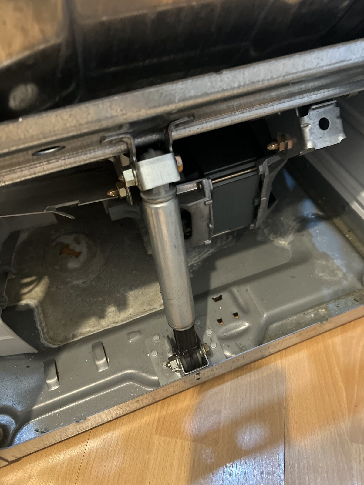

Hi all. Managed to get the machine up and running. It was the motor brushes that needed replacing.
Can someone tell me if it’s worth replacing the shock absorbers pls?

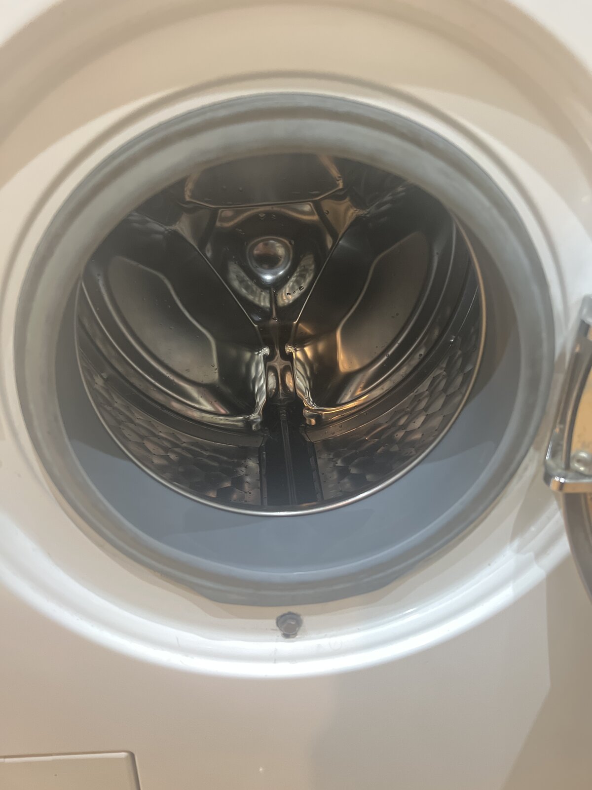

Evening all.
I Had a wash on today and noticed water leaking from the door.
Can someone please tell if this currently looks okay or do I need to replace the seal with a new one?
