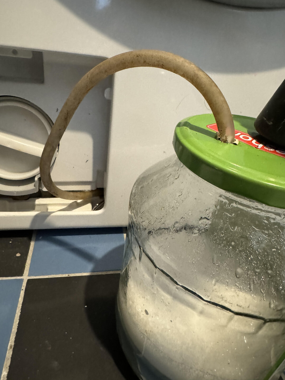

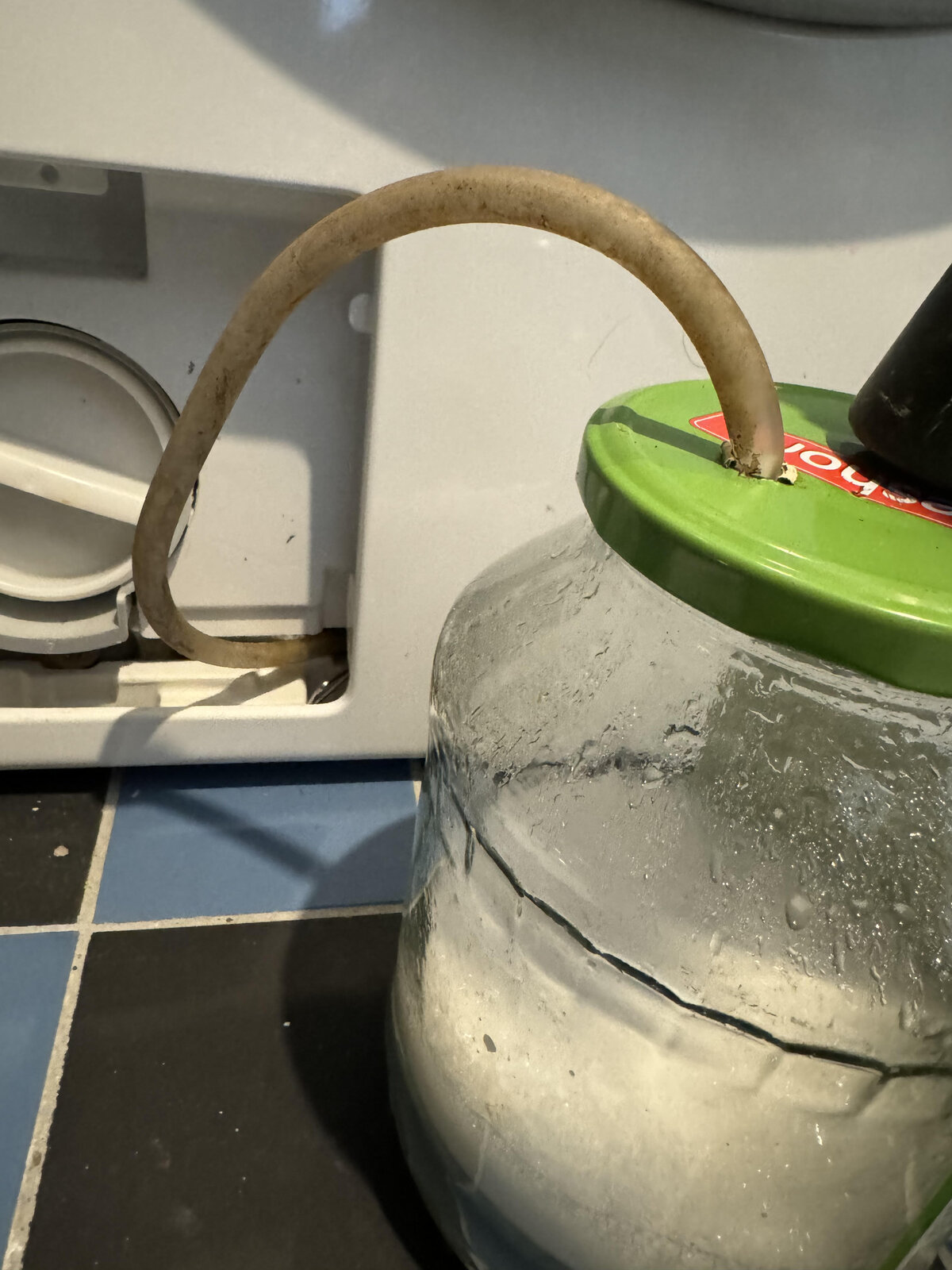

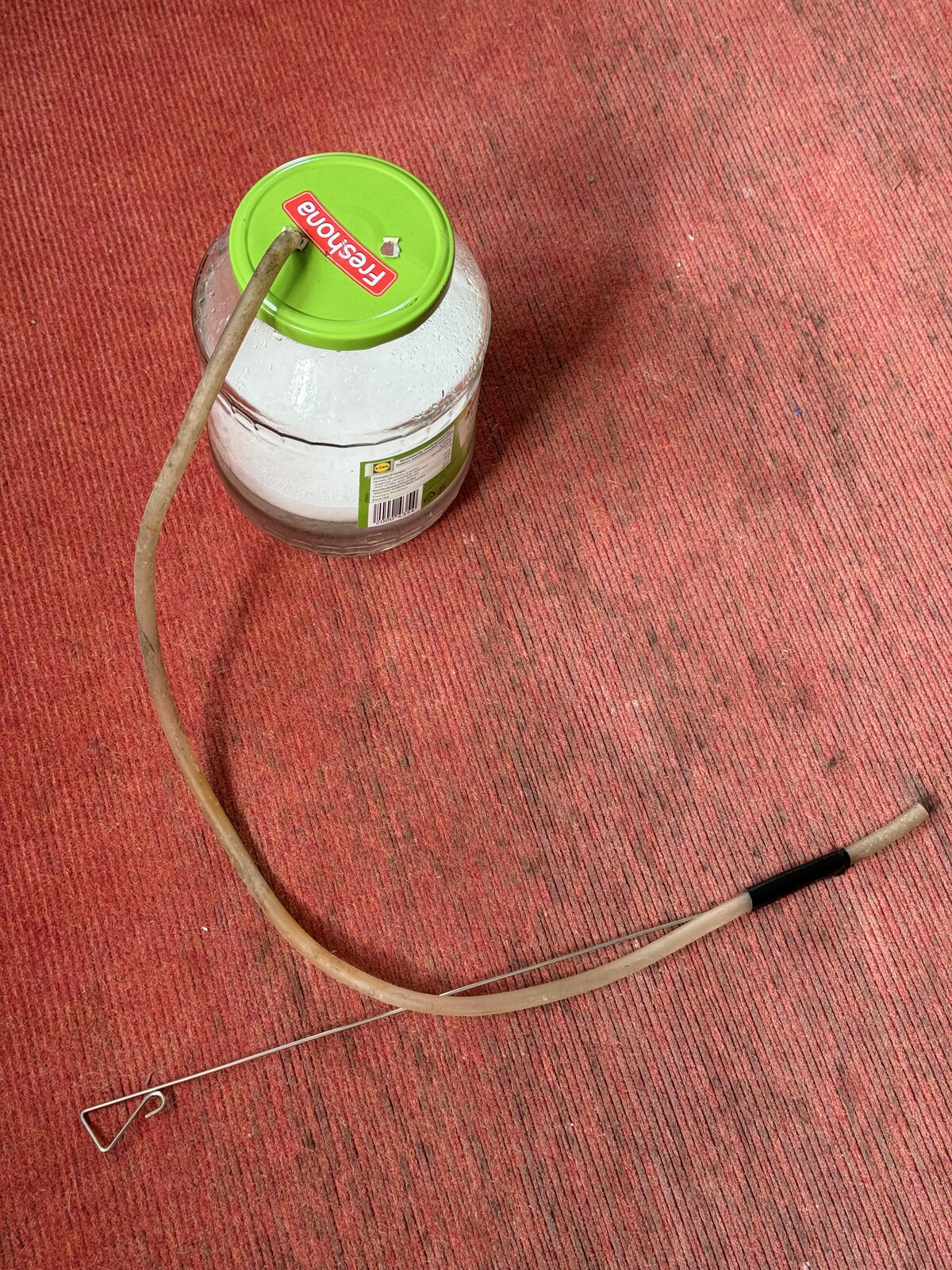

We encountered a similar F138 issue on a new Miele after running a wash without the detergent drawer and opening the filter with a lot of water spill. As a result, there was a significant amount of water in the bottom of the washing machine.
I think the following method is useful if you have limited space and time, and if you are fairly certain that the error is due to an unforeseen water spill rather than a leak. If a leak turns out to be the cause, the error will return.
I was able to fix it without tilting or opening the machine by using a regular vacuum cleaner indirectly to a watersuction hose: I attached a flexible hose about 50 cm long 1cm wide to a steel spoke with duct tape, so the end of the hose could hang down a bit and could be directed using the spoke. As a reservoir I used a large glass jar with a screw-on lid, made two holes in the lid with a screwdriver, and inserted the hose into one of the holes, any alternative stiff jar can do. I screwed the lid onto the jar, removed the filterdoor by lifting it out, and inserted the hose about 30 cm into the space below the filter towards the center of the base (see images). Then, I used a vacuum cleaner to create suction through the other hole in the jar lid. (Do not connect the hose directly to the vacuum cleaner since water will be sucked directly into the cleaner). I sucked out all the water (about 250 ml). After that, the error code was gone and machine worked again. If you have the materials, it takes about 15 minutes without moving the washing machine.
