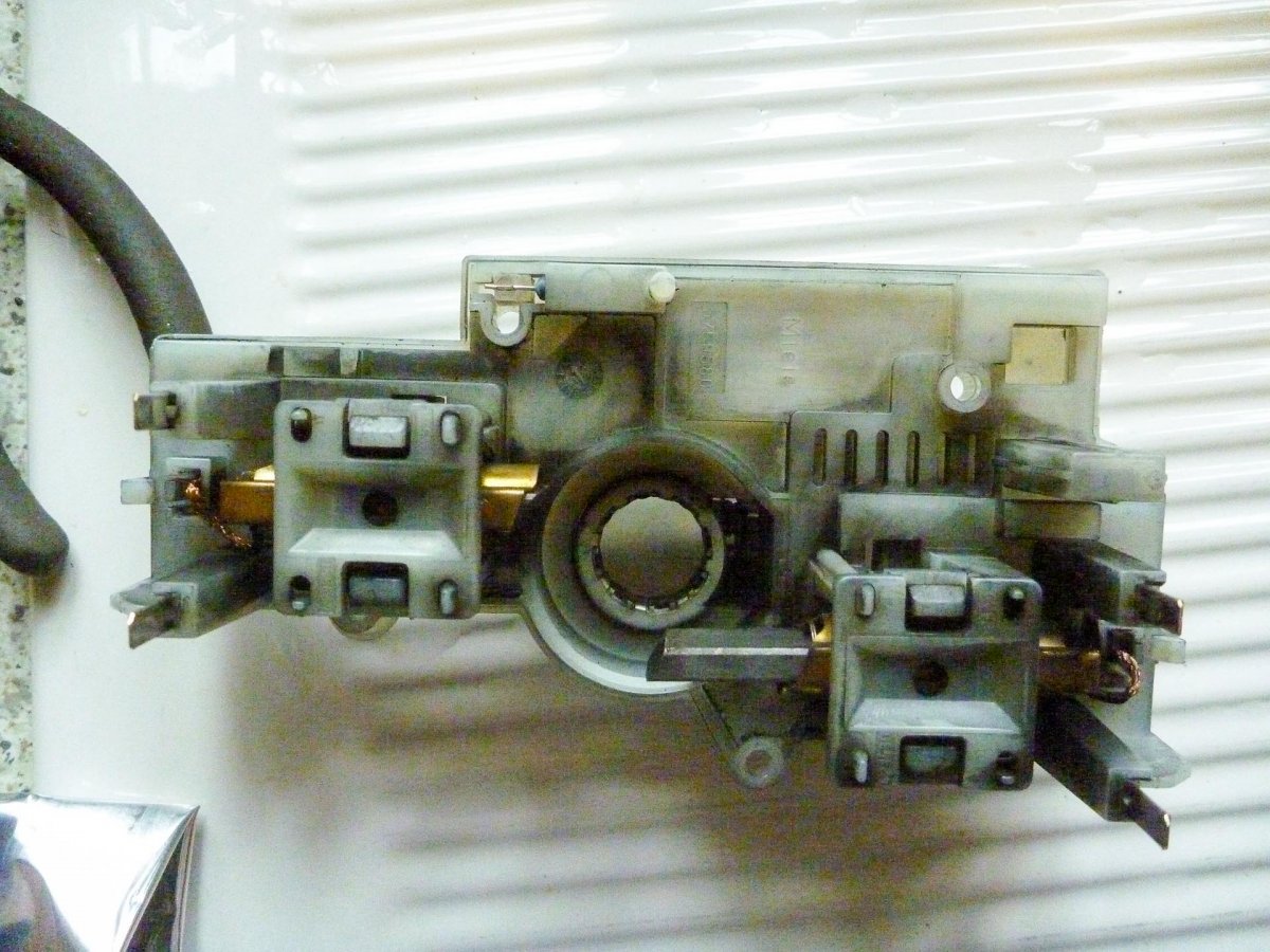

In addition to brushes, you need to change the two 0.01uF X Rated caps in the brush carrier. These reduce arcing and wear of the brushes. Miele Motors are built like battleships, rarely give trouble, but the motor-Controllers and brushes/caps do.

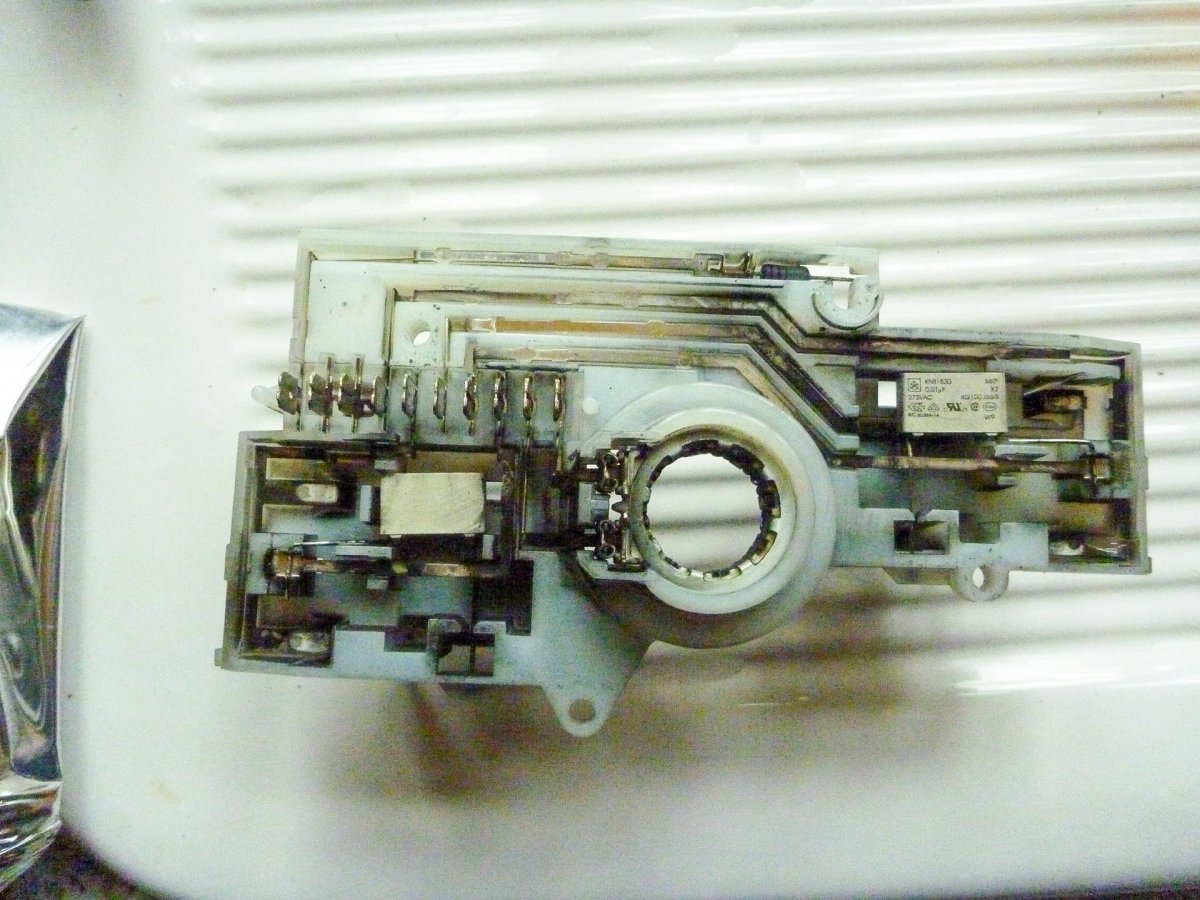

Now dismantled and, sure enough, it's one of the brushes again. Interestingly though, it's the LHS brush viewed from the front not the RHS as mentioned in the earlier post - see pictures. Honestly cannot remember which one failed last time.
Have purchased new capacitors from Maplins. Only snag is leads are 20mm long whereas they really need to be 25mm to fit the holder. They are secured mechanically, not soldered. My plan is to solder and extension to them.

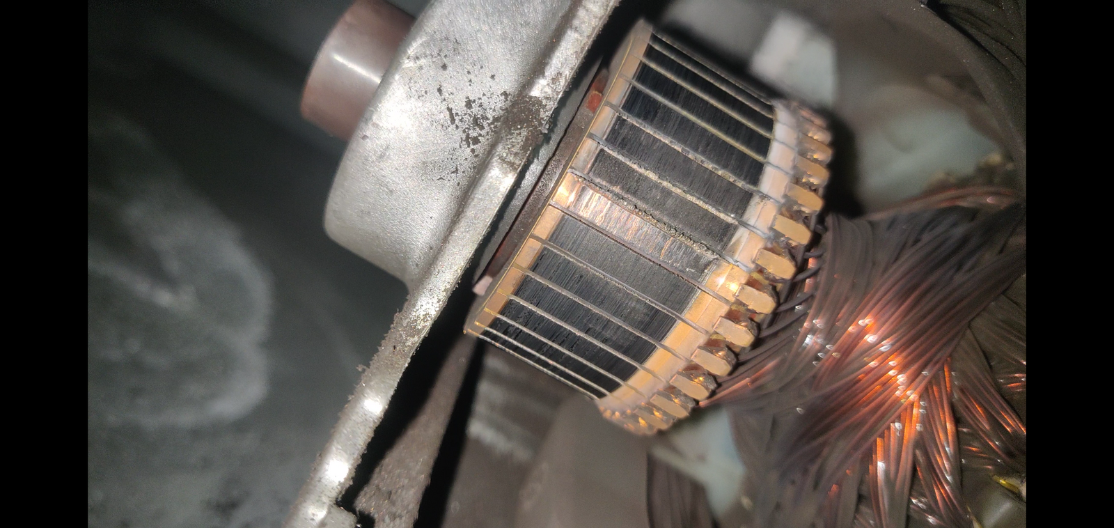

Now then- Sorry for reviving this old thread, but my w562 prestige plus 6 has the same issue (plus another which is why I am posting)
uneven brush wear, I have just replaced them (to replace the originals if I am correct) however the commutator has a couple of 'pits' on it which cause the brushes to make a ticking sound when the machine is in use. can anyone tell me what has possibly happened with the commutator? Pics attached.
TIA :)
