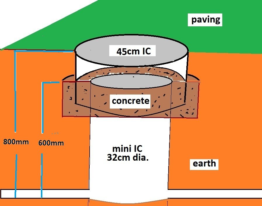

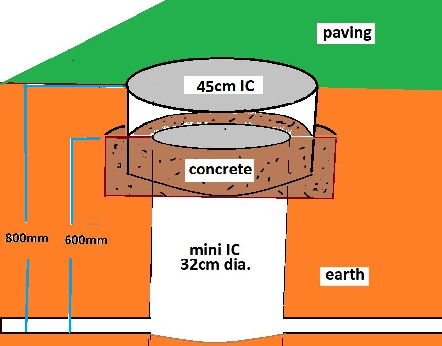

According to Building Regs H1 Table-11 2015 approved doc, our 800mm deep mini Inspection Chamber (with a +-32cm internal diameter) should not be deeper than 600mm. I believe this is to ensure effective rodding from above.
Q: Could I bring this into compliance by removing the top 200mm riser section and concreting a 450mm IC barrel around it with a 450mm cover at original ground level? Rough sketch attached.
This would make the mini IC 600mm (invert to cover) but the "ground level" immediately surrounding it would only be a +-12cm wide ledge. Don't know if this would comply with regs.
Thanks,
ian

Maybe you need to consider who fitted it and how long ago.
It is only a small amount outside the specifications and not something that I would expect would upset anyone.
The regulations are written to be complied with but there are no drainage police going round with flashing blue lights about to arrest you.

Hi Agile, thanks for your response.
I had it installed in May 2011 by a recommended specialist. Later that year it transferred to the Water Company together with the shared lateral drain.
If ever we do call Severn Trent for a blockage, it would be bad if they could not rod due to the excess depth.
Regards, ian
Severn trent would find a workable solution, they'll have inherited far worse setups when everything was adopted.
Thanks Andy and Thomp, I get the drift. Will probably leave it as is. Cheers, ian
I don't see it being an issue, it's common practice on Developments now to use 4 and 6" Preformed Chamber bases at deep Invert levels, then build the Chamber up using 1200mm Diameter Concrete rings.

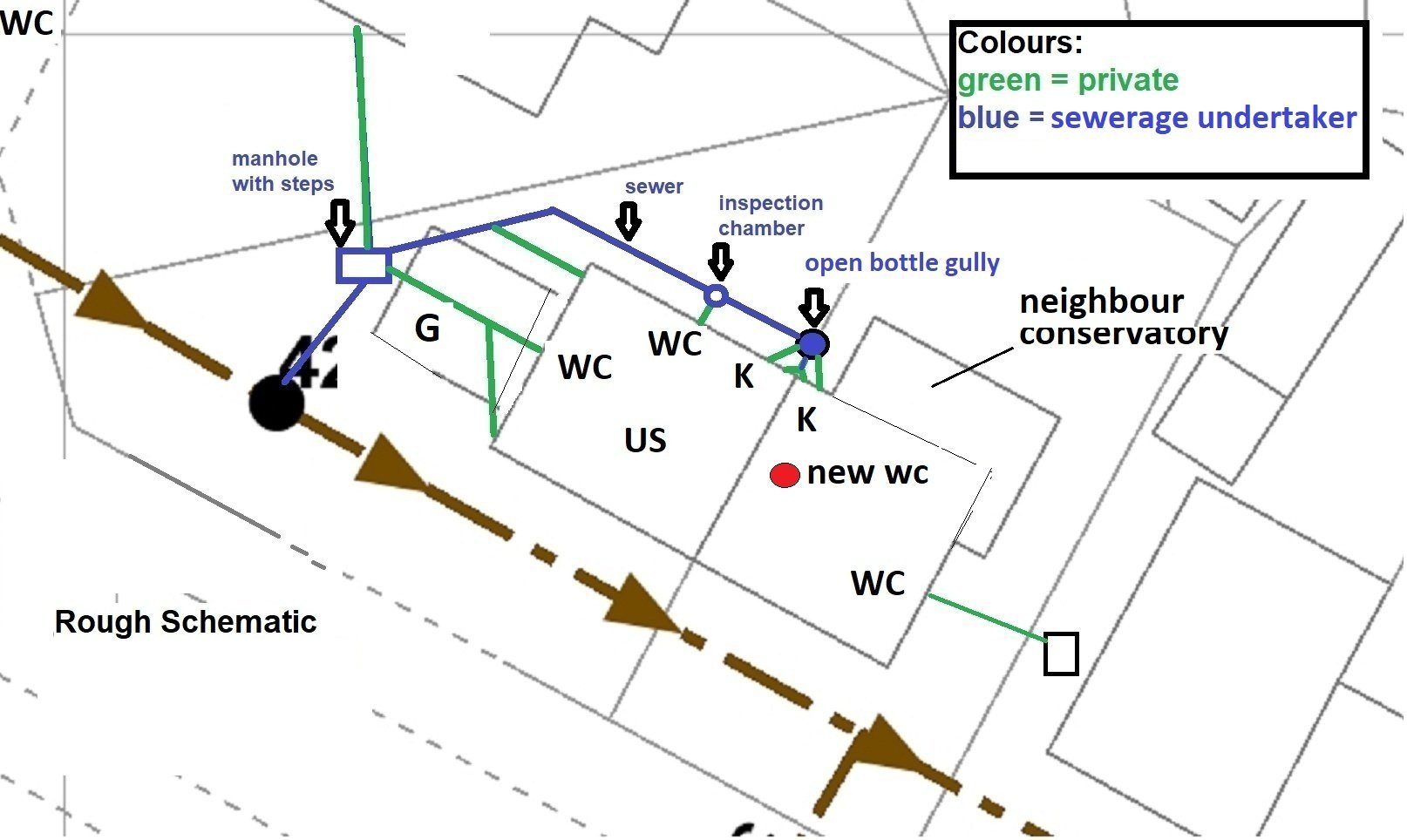

Severn Trent will be inspecting soon due to my complaint about the neighbour connecting a WC into the shared open bottle gully on our boundary, believe it or not, just outside our kitchen window.

Never mind Severn Trent I'd be getting Building Control and Environmental Health from the Council onto that. Gully would normally do one property, so I'd expect that section to be classed as Private, ST wouldn't get involved until it joins the main run.

Severn Trent have confirmed ownership of the bottle gully but it's a tricky one. You are right, probably going nowhere.
Environment Protection team sent a Nuisance Control officer who says he might be able to raise a nuisance claim if/when it stinks and he can see turds etc. Maybe I should pray for a few floaters.
Owner is a single guy still renovating. Very light use of the 2nd WC. Hope he doesn't sell to some poor innocent family.
Plan B is to cover the gully and reroute our "grey water" to our own private stack, leaving the neighbour to deal with any blockages.

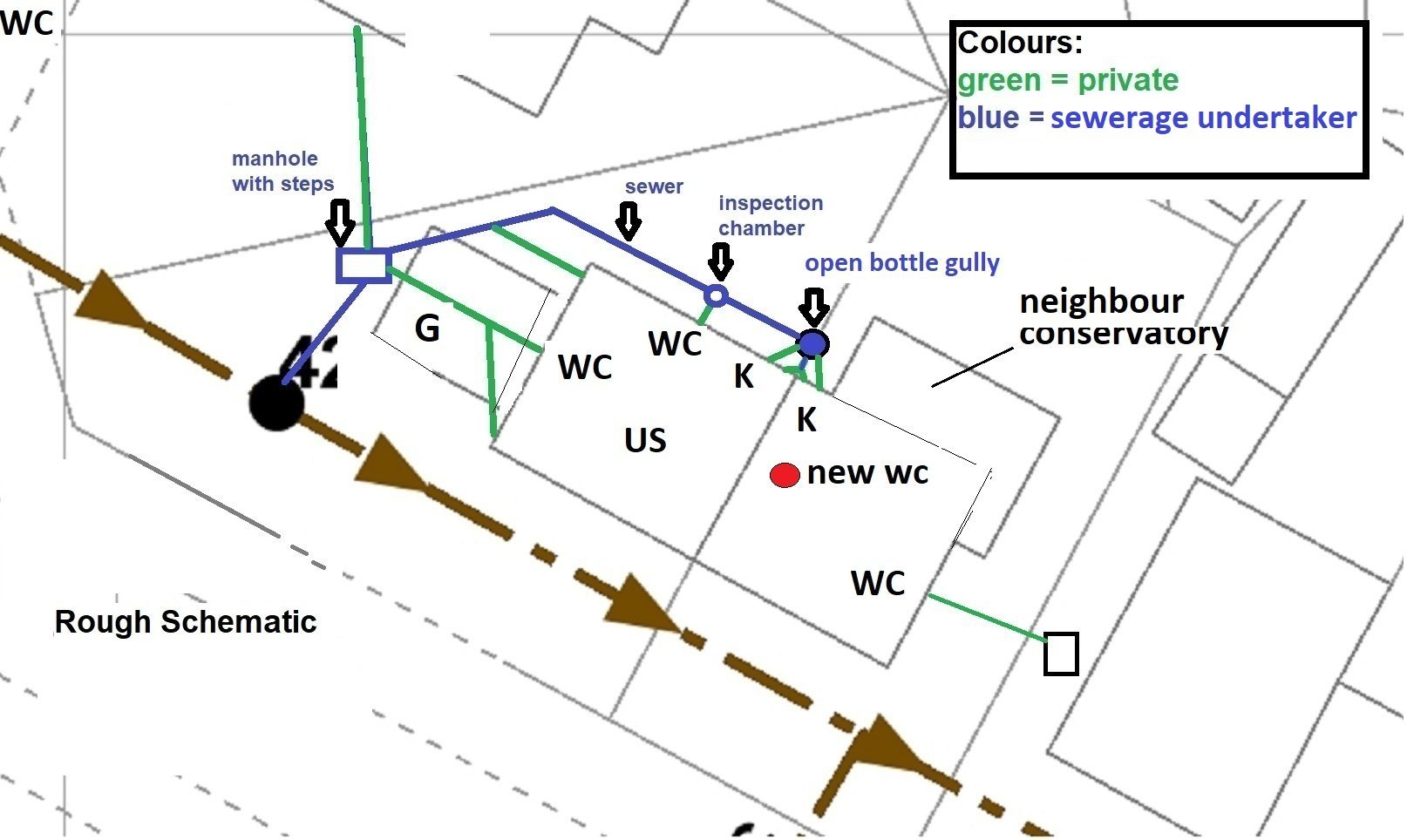

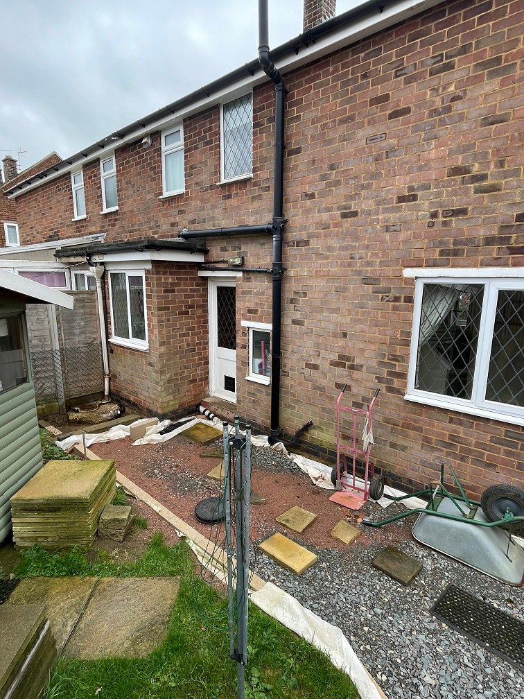

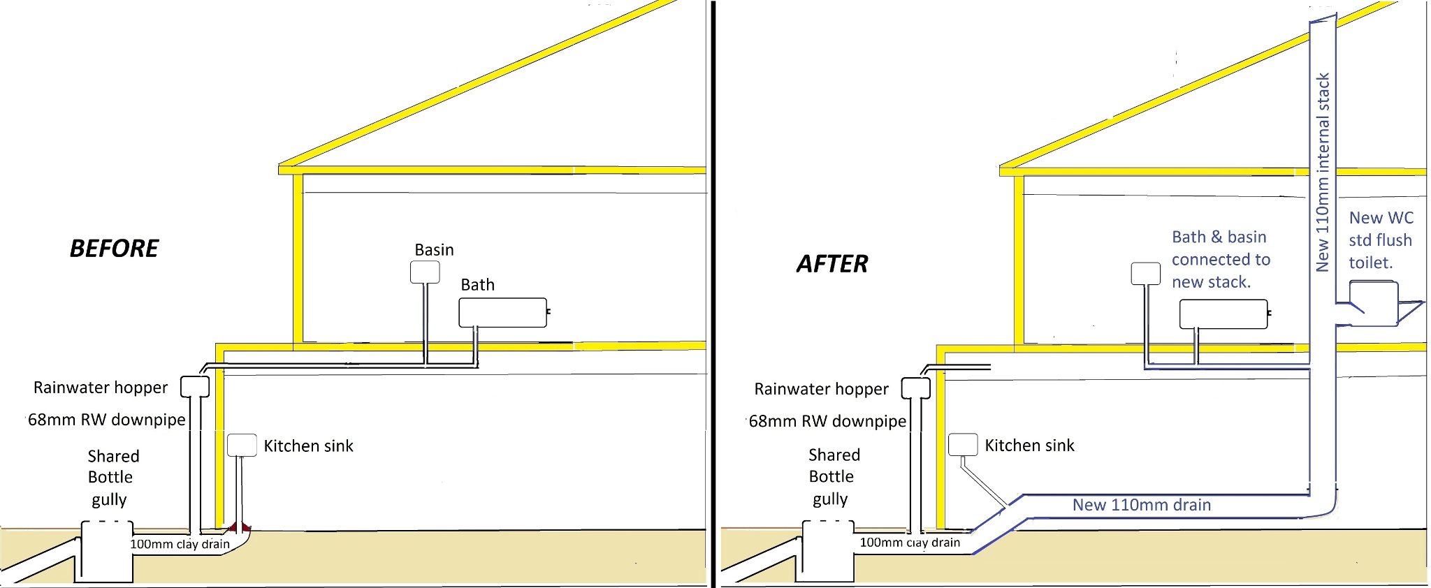

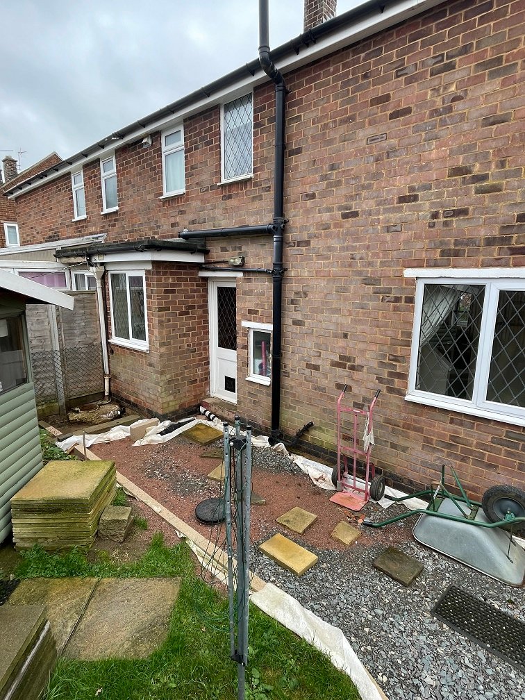

Can you give us some more details, (ideally pictures!) of what has been actually done next door?
Waste Pipes, i.e. from Bath/basin/shower are allowed to discharge into an open hopper if that has always been the case. (Hoppers are not allowed as part of a new installation.) A WC must be directly connected to the drainage system, via a stack if on an upper floor.
Hi Hugh,
Here are some files should they be of interest.
Neighbour has consented to pay half if I fix it, so it's either that or plan B (as mentioned) and getting that long delayed paving done.
Your kind concern has been most appreciated.
Thanks again and take care, ian
p.s. assets shown in blue were confirmed by Severn Trent as theirs.
