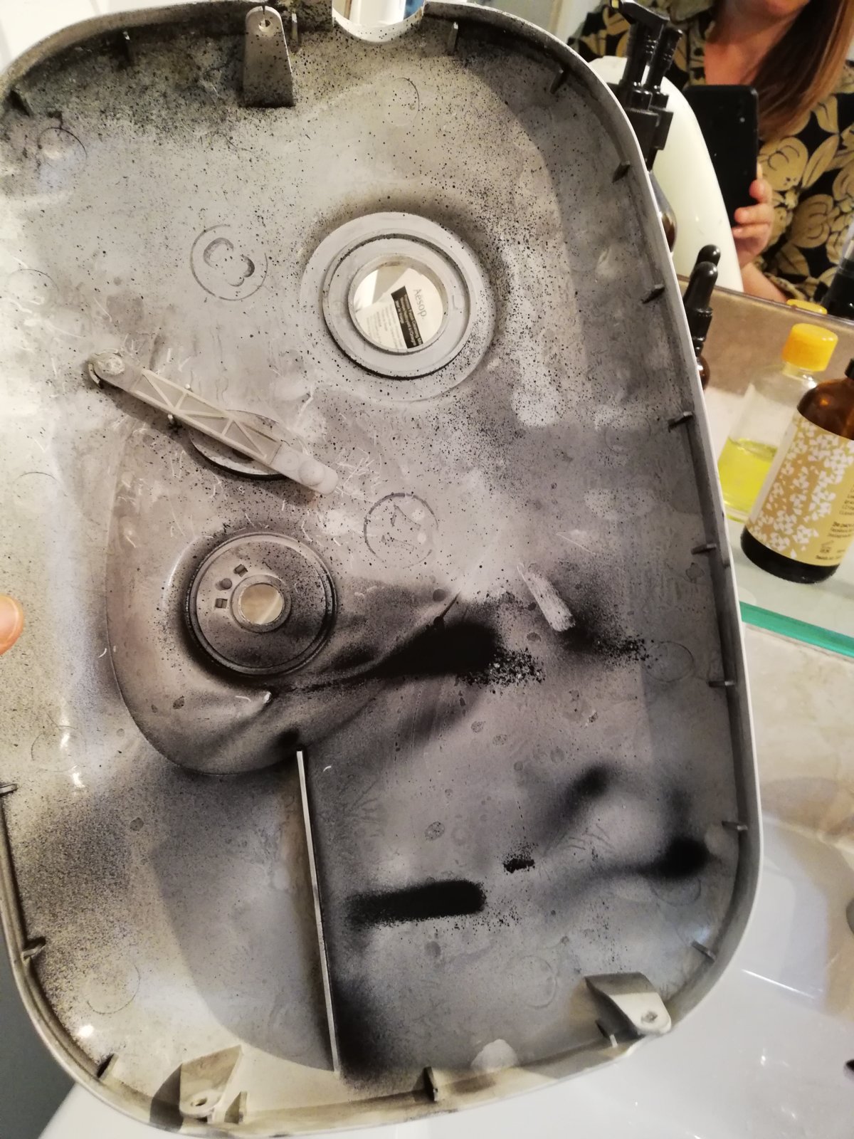

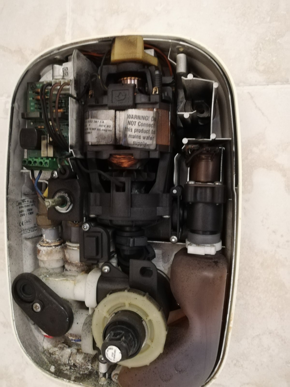

Hi DYI heroes,
Our shower wouldn't stop pumping water this morning. Button got stuck. I switched off the mains and we've just opened the case to find that it's got an enormous amount of black soot inside (it covers all the different internal parts as well). We can fix the on and off mechanism inside by glueing one of the parts back on, but we're worried that all this black soot means something else is going on that's not very safe... Any ideas?

you probably have a bad electrical connection inside that is overheating. Turn off the power supply and post some photos please, especially of the connection block.
Is it a power shower? - if so the carbon brushes in the motor may be worn and need replacing.

As Blup says, it's carbon dust from the brushes. They're always black inside. Don't worry about it if it still works
It could be carbon brushes,but could also be from a bad connection (usually neutral) as stated, a photo may help better to understand.

If it's just the on off button and that can be fixed then you could give it a go as suggested above because the soot and the broken button don't seem to be connected issues.

I have a Mira Event and it gets extremely used. The black is 100 percent the carbon and its messy as hell. The events are good and spares carried by the mira own engineers who you can book if you call Mira or have a Home serve insurance policy or similar covering your shower. I have had several motor replacements as they can also get noisy when worn. Great showers though as far as internal pump power showers go. You should also be able to order Mira spares.
