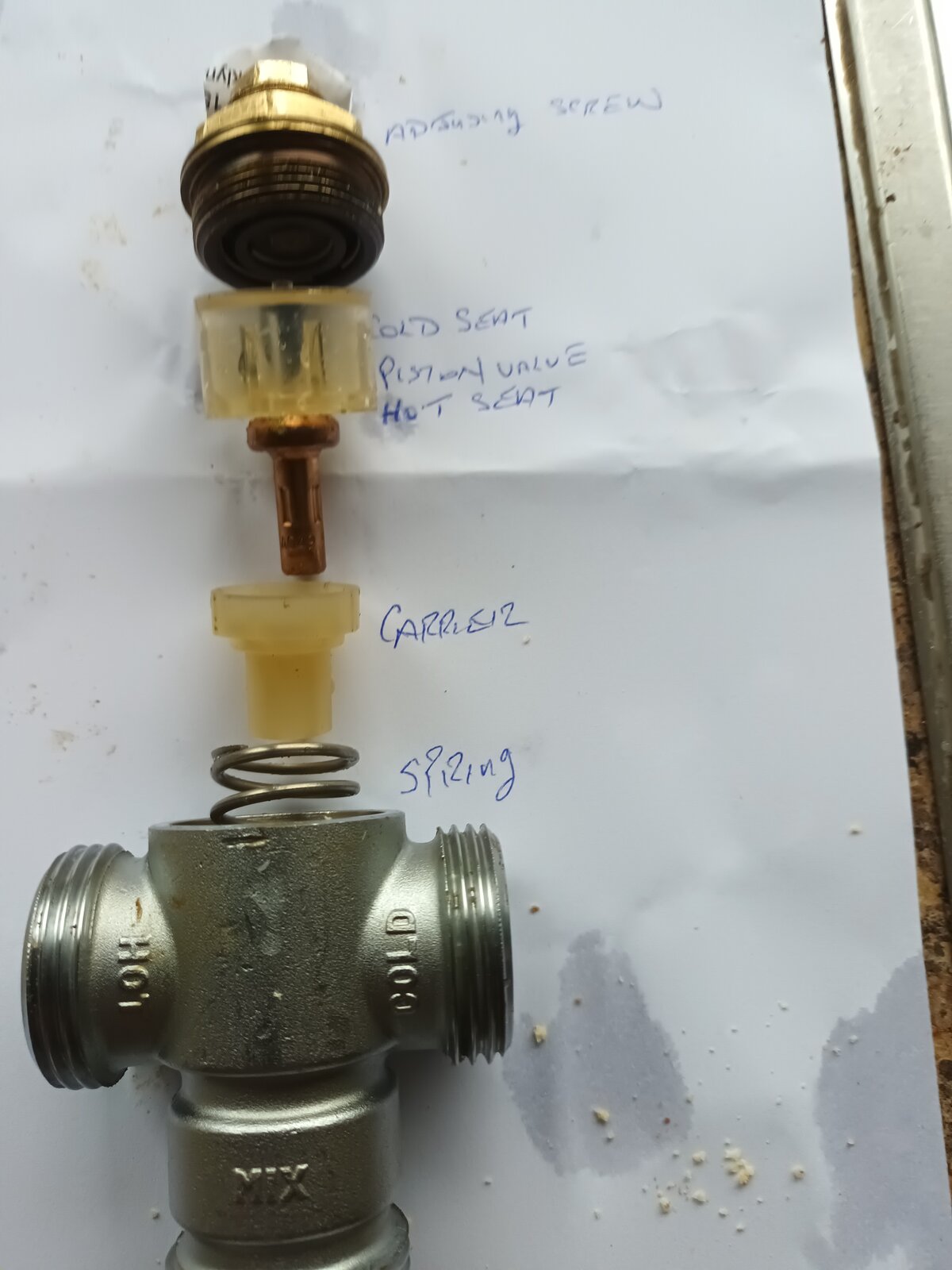

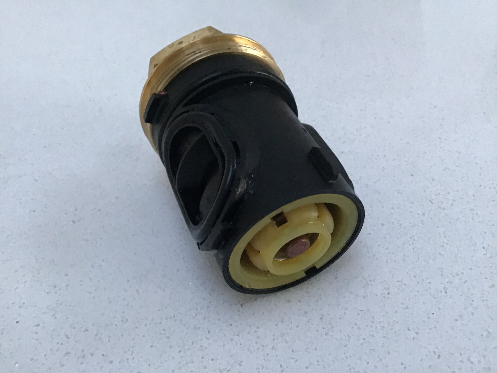

Yes, that seems fine , the only one I opened had a one piece plastic piston with a sealing rubber O ring in the valve body to stop the hot & cold water leaking past the piston and short circuiting, the piston only moved ~ 4 or 5 mm and if both pressures are exactly the same, then both will only supply exactly the same volume of water when the piston is mid position.
For interest I will post a few photos of the one I opened up, shortly.

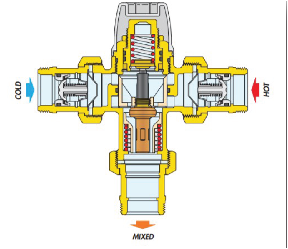

The Altenec One seems to have a adjustable piston stroke via the top cap.

The first photo shows the hot inlet. the ‘o’ ring that is round it seals it against the brass body of the shower.
Before refitting the old cartridge you might turn it to fully hot then pour very hot water down the mixing port, water should then stop flowing out the hot port and should flow out the cold port if the thermostatic element is working and hasn't lost its liquid or wax charge.
