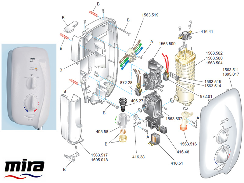

Hi all we have a mira shower sport that I had to replace the valve assembly on and all was fine had to reset the temperature settings as per instructions and all fine but now I have to do this all the time to and go through all the settings in order to get the required temperature? What am I missing?
Have you tried a reset. Basically powering off for 15 seconds. Look it up.
Must have a battery or capacitor holding charge to keep memory.
Cable or battery dislodged?

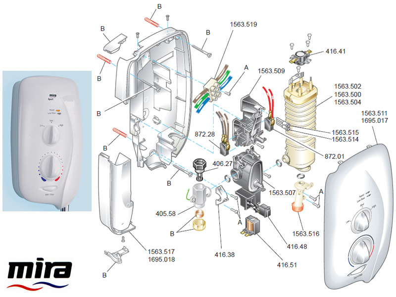

Hi Wayners, any idea which part I’m looking for in the image?
PCB
Can't see it in diagram. Has yours got one you can see?
