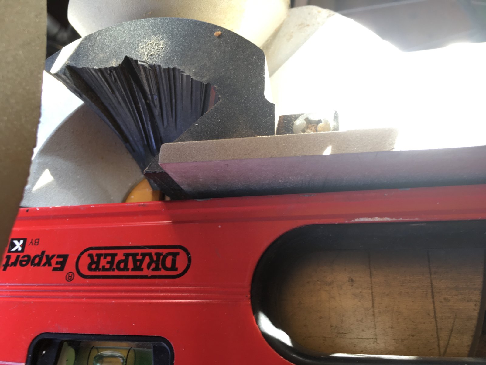

I've borrowed a mates DeWalt mitre saw. Halfway through making the raised flowerbed, I noticed this....
The back guide plate or whatever it's called is not straight. It deviates from the centre line on both sides (ignore the chewed up plastic thingy).
So if you have to cut an inch off a piece of wood, and one lines up the wood with the back guide, you get something other than a 90deg cut....
There is no visible damage, it's a piece of cast metal, no cracks, all looks kosher. Is this how it's supposed to be?

De Walt 707, discontinued. I don't see any damage to the fence and the misalignment is same both sides. That is, with a straight edge across the fence, both sides veer off to the middle.
The fence.
You mean both sides is one single continuous piece of metal, like this?
Is so, then it's knackered. If the fence is in two halves, both sides can be adjusted so they are straight, then reset the 90 degree adjustment after.

Ok so it's a single piece fence. If those two faces don't have a flat parallel line, it's damaged. Replacement new is £50ish.
Using the straight edge across the back fence (your level), check the blade against it for 90degrees. If it's out the positive stop plate needs adjusting, my understanding is there is very limited movement in the fence on that saw and other DeWalts are adjusted by the movement of the stop plate.

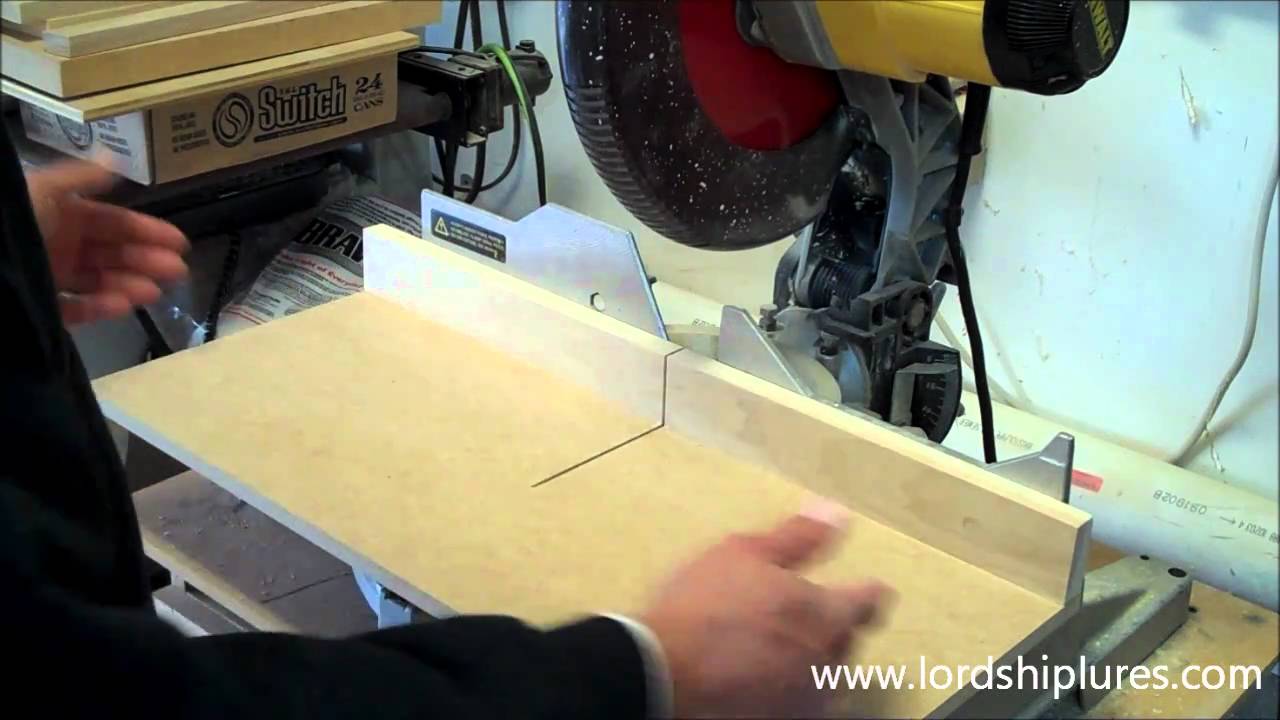

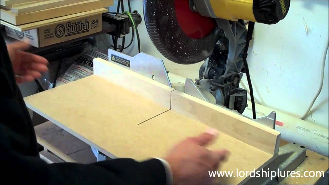

So presuming it's square but you still have the issue of the fence showing out, I would take a decent bit of ply just over the width and depth of the saw table and fix a piece of construction standard timber to the back then clamp it up to the fence.

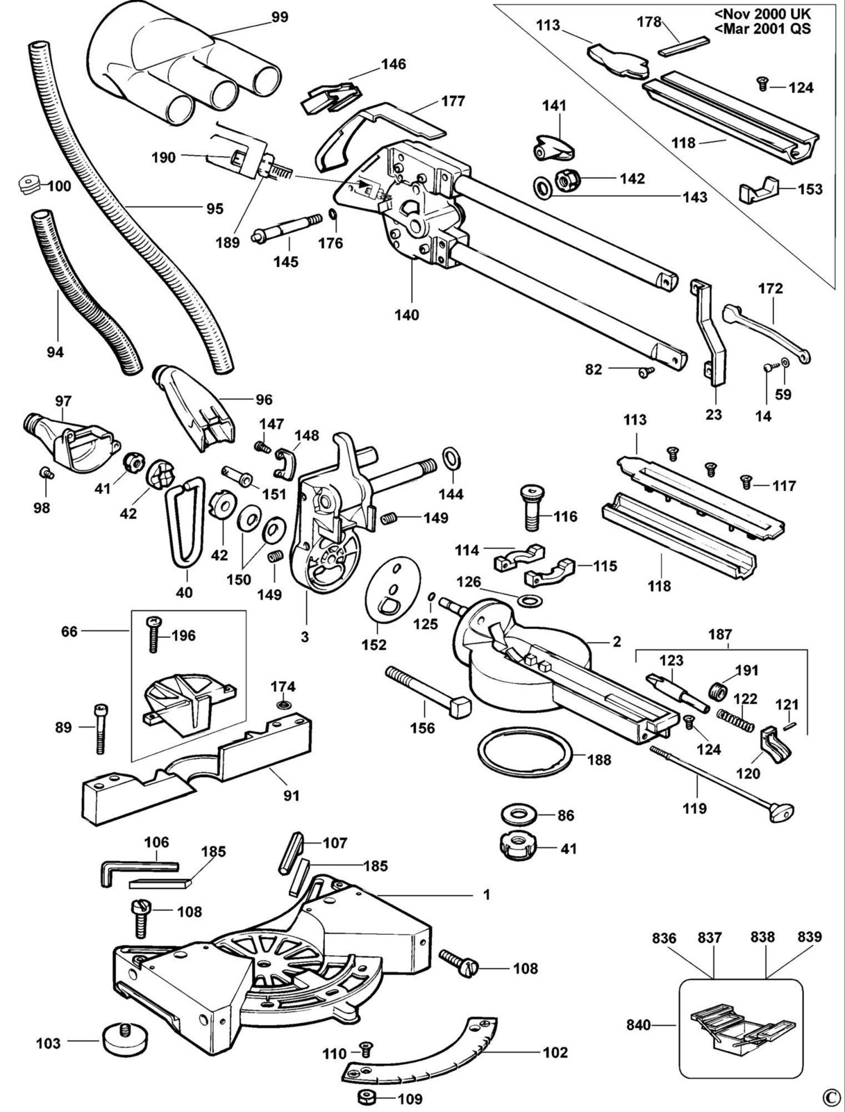

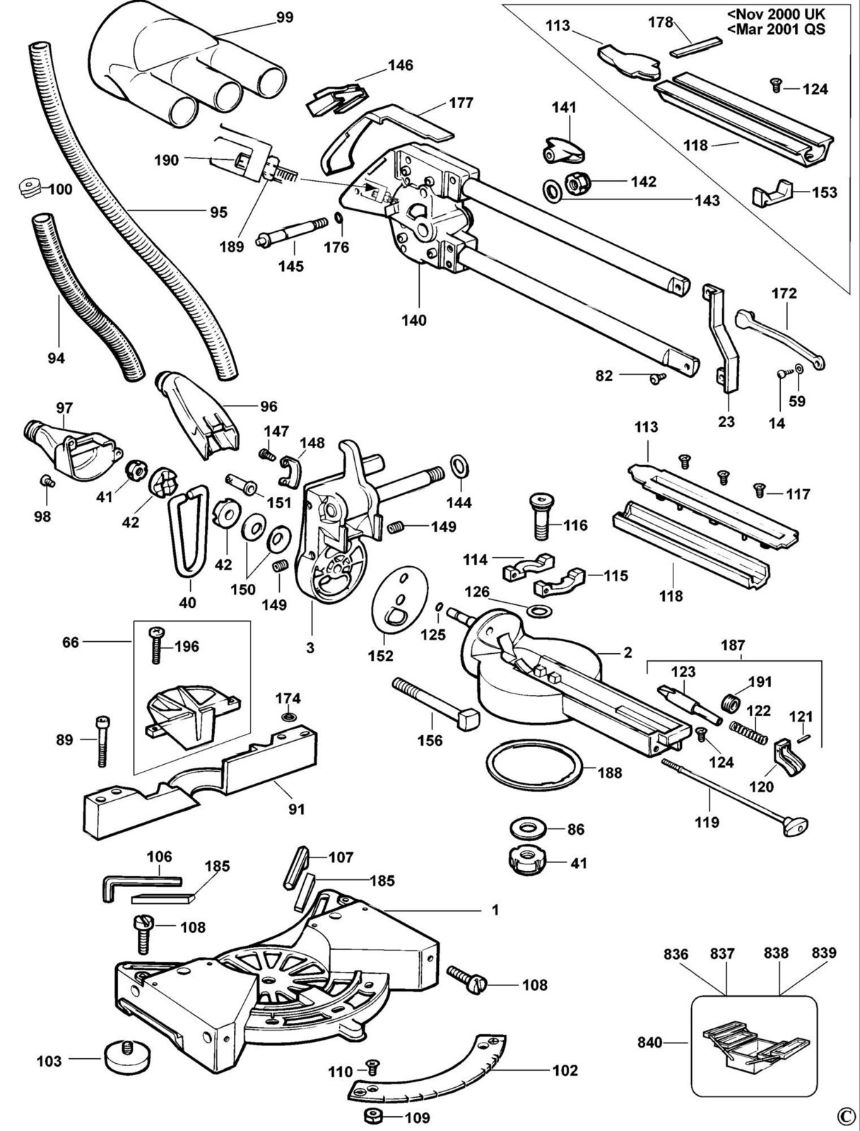

De Walt 707
Part No - 868687-00....
https://www.partshopdirect.co.uk/dewalt-dw707-type-2-mitre-saw-spare-parts-s5913/
Wouldn't recommend a new one as easily straightened when removed.
I always screw on a 3 or 4 meter auxillary fence to the left and helps reduce kickbacks, protects the alu fence and makes stop block setting for repetitive cuts easy.
