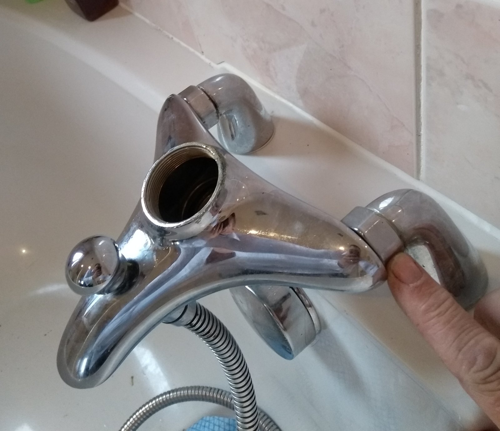

I have a bath/shower mixer tap which has started leaking. Unfortunately I am having trouble locating a new cartridge/cassette as the tap is probably about 15 years old.
I dont really want to start removing bath panels (I think the previous owner seems to have made them a non removable fixture. They are wooden and I cannot see a way of removing them without breaking them)
My question is
Can I undo the two nuts (as indicated in the picture) that hold the main body of the tap and simple replace it with a new body? Obviously, any new one would have to be the same size fitting and the distance between the pipes would have to match. But if this is a realistic option, I could remove the part and take it to a plumbing outlet to get one that would fit.

Yes you can. But you may have to go on a mission to find one , good luck .regards Terry.
is the mixer thermostatic ? Whats the measurement between the nut centers,where your finger is point to ?
Non thermostatic units with 150mm centers are available from victoria plumb, apollo bath shower mixer.

Yep, 150mm centres, non thermostaic - sounds promising.
The spanner size for the nuts is about 30 mm and the thread size looks to be about 25mm, I am guessing (hoping) this is standard (1 inch?)
Most likely 3/4 bsp thread.why not post a pic of valve and tap head. You may be searching for the wrong description .

Dunno if I've misunderstood you. The measurements were taken with calipers and are the nuts that I am pointing to in the photo, the diameter of the hole where the cartridge (Cassette?) fits is just over 40mm
The nut that your finger points to in pic ,( and the one on the opposite side ) are most likely 3/4 bsp thread. A bit confusing ,but the thread size does not relate to the outer diameter. Welcome to the world of plumbing !!!
The hole that the ceramic cartridge came out of may well be 40 mm ,I passed no comment on that. Regards Terry

victoria plumbing as mentioned do the apollo bath shower mixer,mail order only.
Toolstation do the Barra wall mounted bath shower mixer 48009,in stock at many of their branches use their branch finder to find local stock.
The above are similar looking taps to your existing although other bar type bath/shower mixers are available.Just swap the tap from two nuts including new 3/4 inch sealing washers. The threaded connections should be the same but there is always a first :idea:
