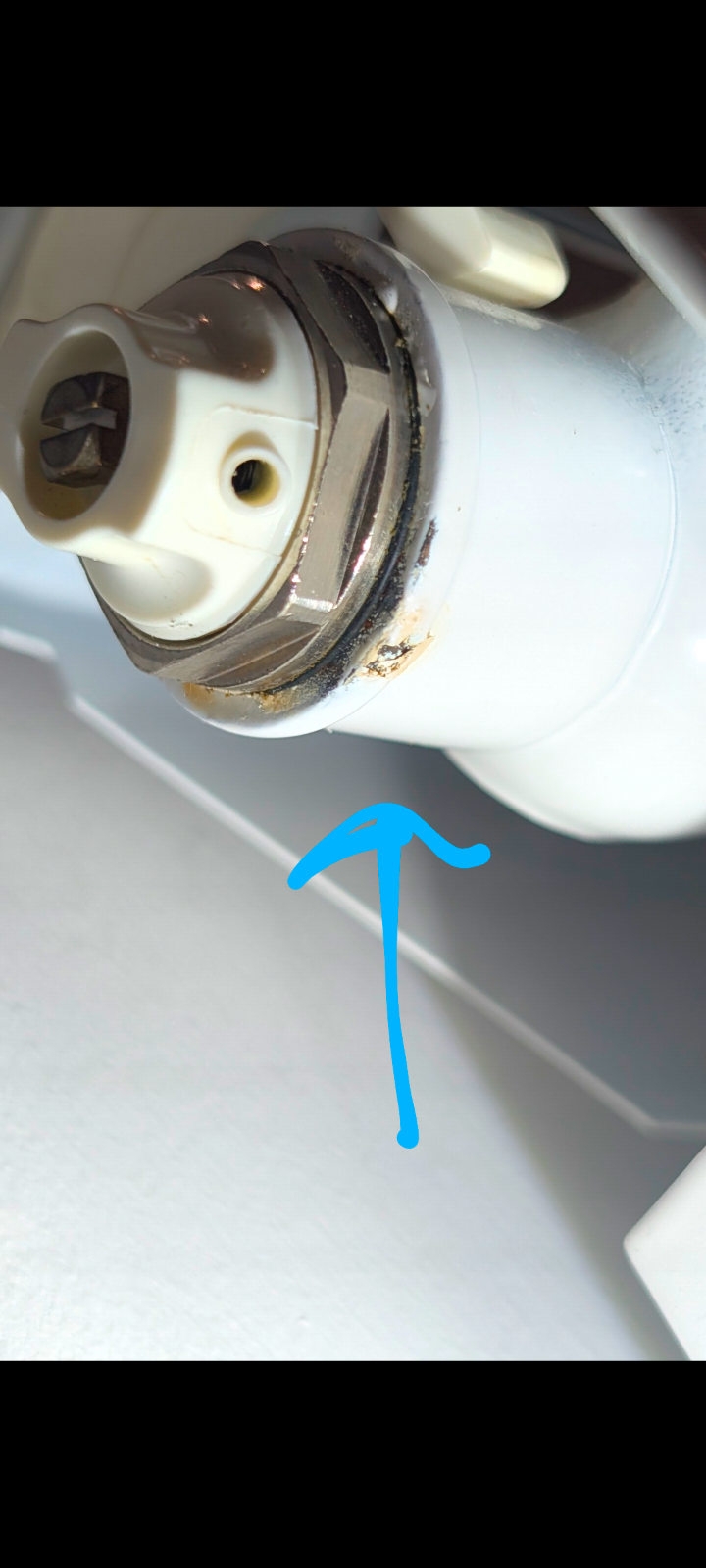

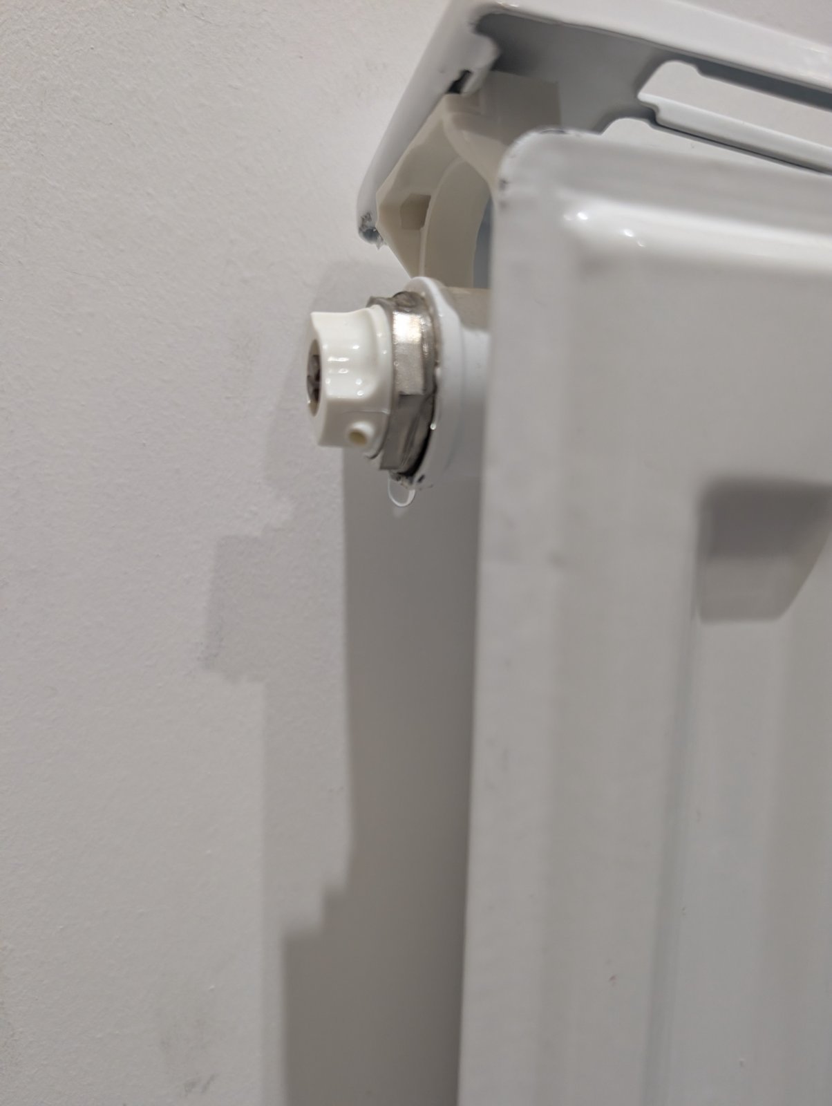

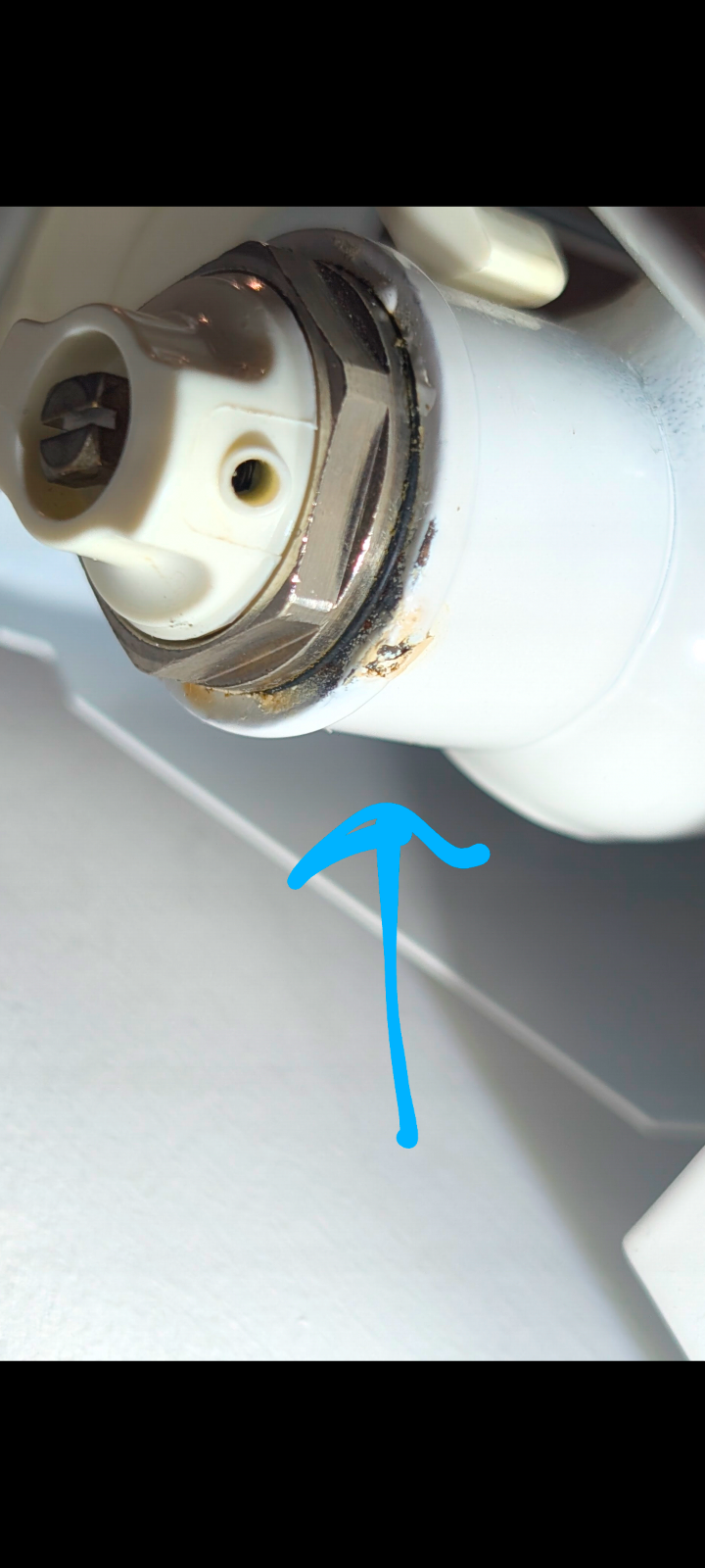

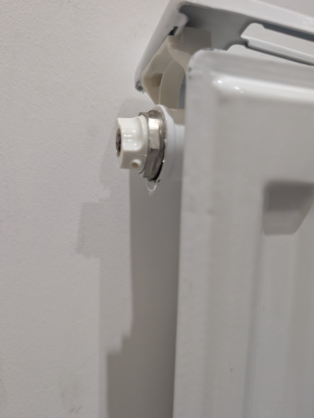

Thanks so much all for the helpful replies, after some rummaging I found the leak on a bleed valve as Exedon recommended, so saved me clogging up the system with leak sealer!
It was only leaking when cold so made it a challenge to find.
I nipped it up as it was loose and seems to have stopped leaking. It's a little rusty where it was dripping , I have seen worse but would you recommend to do anything to this area.
Thanks for your help a big problem solved!
These bleed valves seal against the raditor by compressing a rubber O-ring. This detiorates with time and this may be the cause of the leak. Nipping it up may stop the leak for a while but, if the O-ring is getting hard, then it might start leaking again. Eventually you'll probably need to replace the O-ring.

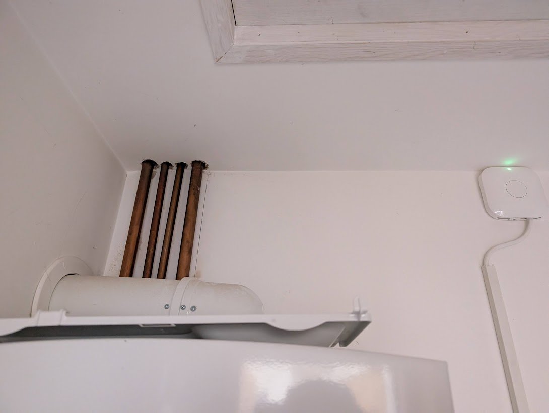

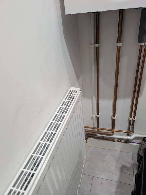

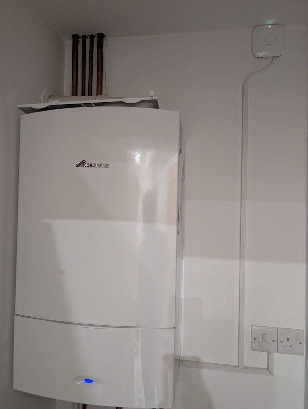

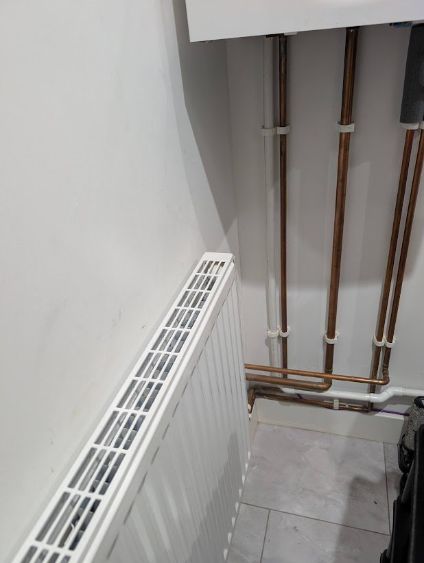

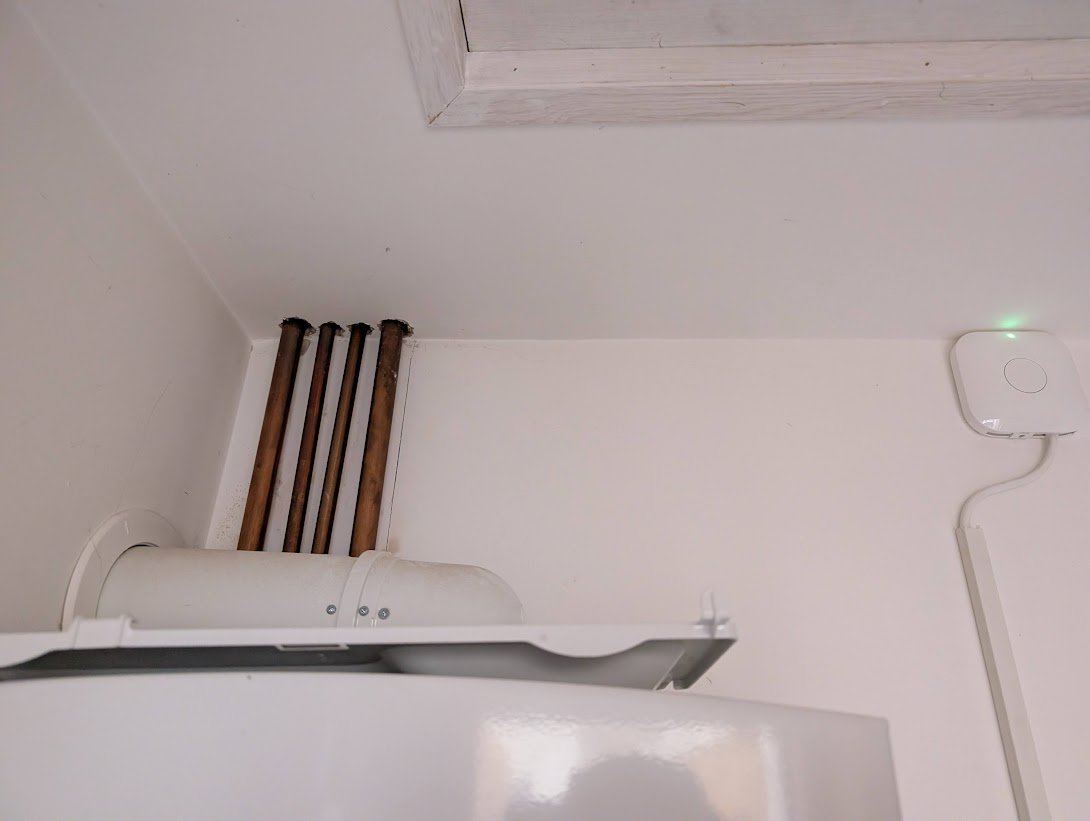

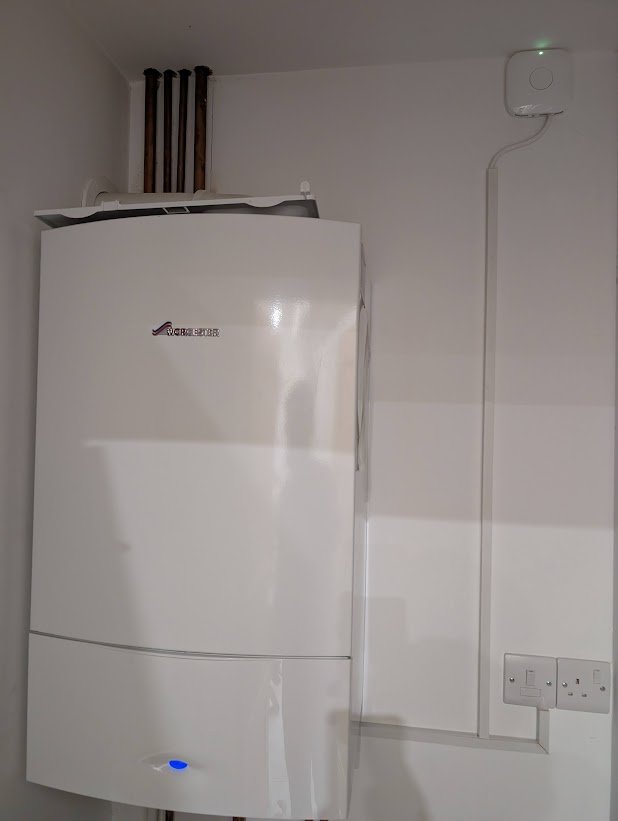

Hi sorry to open this thread again
I am looking to install a magna cleaner for my boiler but the space seems tight
At the top of boiler have in order
Heating Flow pipe, Cold mains, Hot water outlet and Heating return pipe .
Below the boiler
it feeds a single radiator only, no so connection to heating return from wider system. (Single rad flow and return with gas pipe and PRV)
The magnacleaner needs to be installed on the heating return which is above the boiler on the furthest right.
I am keen to install the adey magna clean pro 2 which needs at least 24cm + additional space for servicing.
The magnaclean atom would be better for tighter spaces with 12cm of space required, however I have 16 rads so may not cover. Also wonder if it does leak will be dripping straight onto the boiler.
I can access the pipework in the small loft space above.
The wiring for the thermostat can be moved around.
Wondering what the best solution might be to install one considering the space would be keen to avoid servicing it above the boiler and bring down height wise?
thanks
