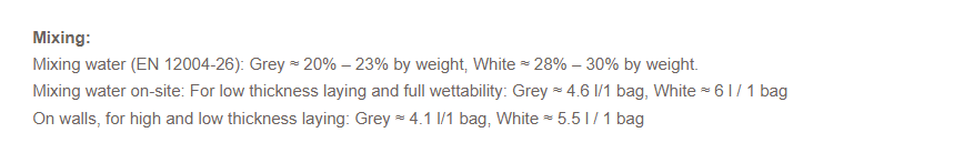

Can someone please tell me what the ratio is for mixing Kerakoll H40 Advanced Gel Tile Adhesive
for ceramic wall tiles. I cannot get my head around the instructions

Neither can I? Why not call Kerakoll's tech dept for simple ratios of water and powders etc.
But why are you using this stuff?
