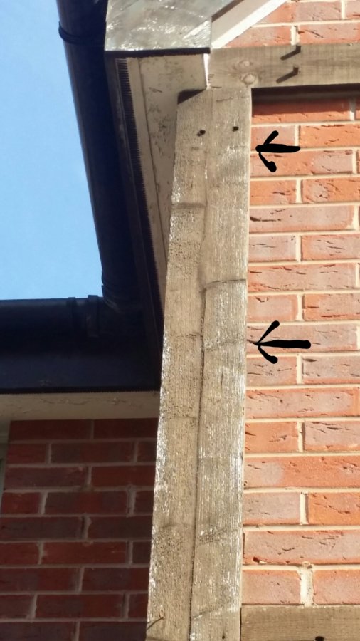

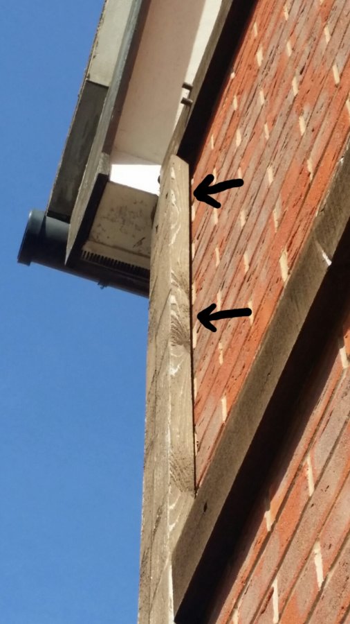

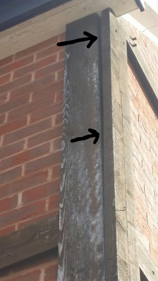

hi guys,with all this wind lately one of the mock Tudor beams has become lose at the top front of my house,it is not dangerous but it vibrates in strong winds and can be heard and felt throughout the house.i have looked to fix it but not sure how as it seems the beams have been fitted using nails(masonry I assume) and not screwed,is there a special type of masonry nail used for this type of fixing as I cannot believe normal masonry nails would do ?..but obviously I could be wrong...any help/advice on what type of nails would be greatly appreciated....many thank
Here are some pics....arrows show the unfixed (loose) area. cheers.
That to me would be an easy fix, put a couple of screws into the face joining the timber on the side elevation and if needed a couple more into the brick work.
Andy
Hi, that was my thoughts too BUT as I am not a lover of heights and didn't fancy using a drill up the ladder I thought maybe I could pop up the ladder with a cpl of masonry nails and bang them in quickly ...that's why I thought there may be some kind of heavy duty type nail that was more appropriate than standard masonry nails....but guess I may have to bite the bullet and use the screws....many thanks
I suspect that use of masonry nails caused this problem in the first place. Masonry screws might be better at pulling the timber back to the wall.
Hi,thanks....I've never heard of Masonry screws but having a quick read on them they seem to be the type of thing I am looking for....cheers
You still need a hole for the screw though.
