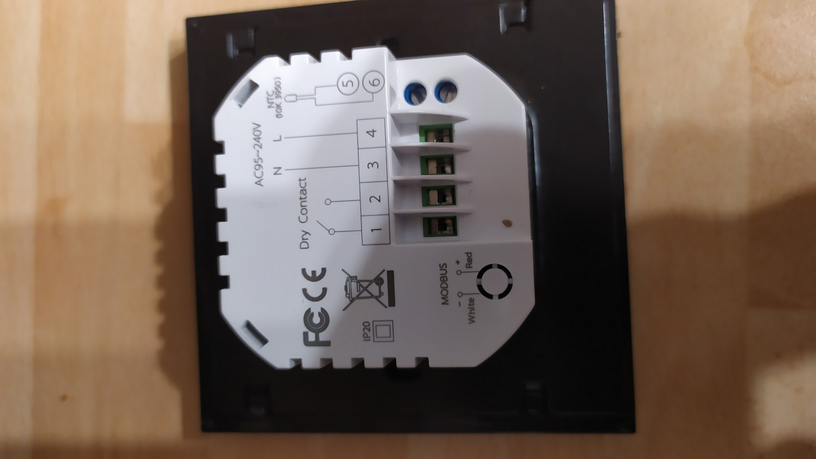

I'm trying to connect a Moesgo thermostat with a Vitodens 100 combi boler.
I've seen some vids, but none that deal with the boiler side of things.
I get the Live to Live and Neutral to Neutral, but am stuck at the signal wiring. I could really use some help. Thank you in advance.
UPDATE: *SOLVED*
I spoke to Viessmann technical support, and they advised the following setup, and it now works.
all on board 96:
L > L
N > N
switch > 1
Hope it helps someone.
