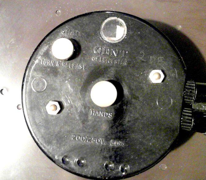

Come to think of it, that reminds me of a mains clock we used to have many years ago. After a power cut, as well as resetting the time, you had to pull out the setting knob and let got to make it start - which would be the "get it spinning manually" option.
Of course, back then, I didn't know anything about motors so had no idea what the knob did internally, only that it started the clock.
