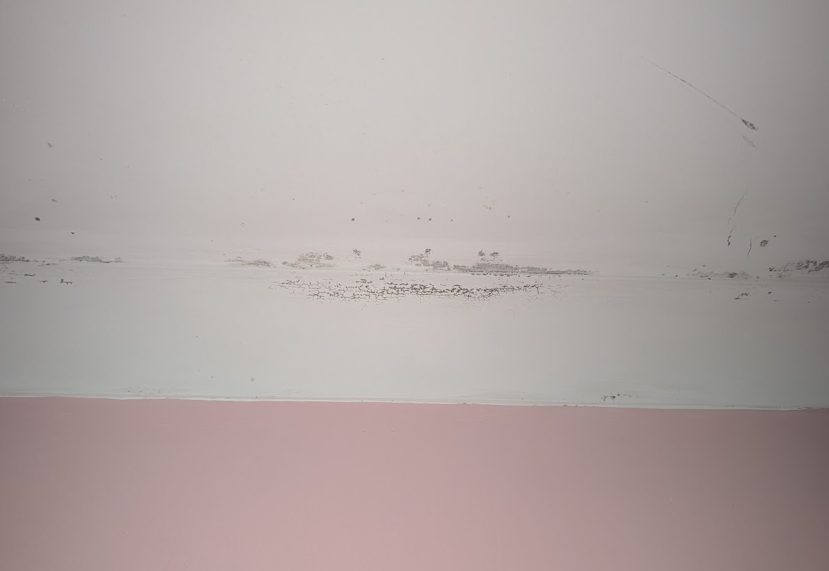

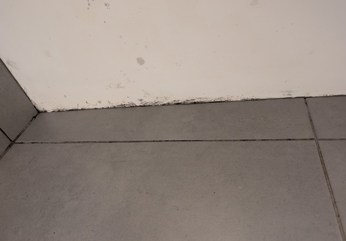

Hi,
Just wondering if anyone has any ideas why we get mould at the top of the walls in some rooms.
It's a 1960s bungalow, 4 out of the 6 rooms end up with mould at the top of the walls, when it meets the ceilings.
We used to have a lot more issues, but we've managed to get rid of it in most places. We keep the place well ventilated. It just stubbornly keeps coming back in the 4 rooms that I've included in the pictures. They are all outside walls, 2 bedrooms, kitchen and bathroom (the one with the grey tiles)
Strangely there are no issues in the lounge or the 3rd bedroom at the front of the house.
Any thoughts/ideas?

These are likely the coldest spots on the walls. Any moisture condenses there.
In the loft, does the insulation go right to the edges?
What is the construction of the walls?
What is the typical % relative humidity in the house?
The insulation seems to go all the way to the edges, but I'll double check that.
Not sure on the wall construction, brick on the outside, block inside with some cavity insulation. Not sure how to tell what it is.
No idea of the humidity, how would I measure that?
A humidity meter?
Warm, moist air rises, cold air falls. Which means the coldest walls are near the ceiling, meeting the moist indoor air - will condense out, at the upper corners of the rooms.
Improve the insulation in the affected areas, reduce the moisure, by bathroom extraction, and a cooker hood, avoid drying clothes indoors, especially on radiators.

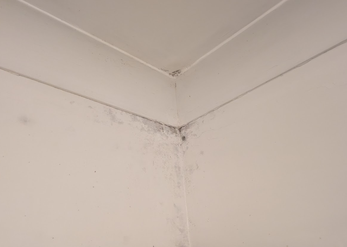

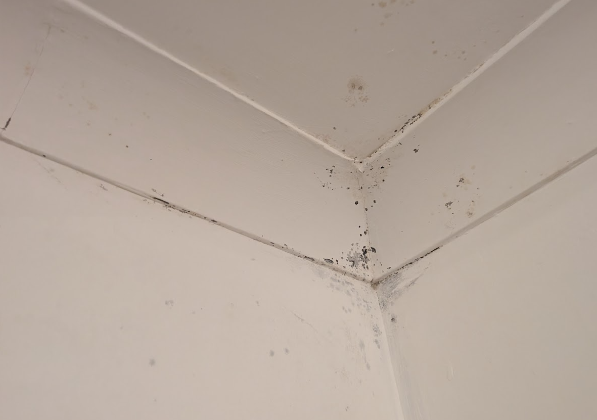

Shaded or NE facing walls will be more vulnerable to say those in the sun. The walls are crying out for insulation and probably an improvement in the loft too.
The wall-to-ceiling joins are often affected because the wall insulation comes up the cavity then stops, the ceiling insulation rolls out to where the roof slope joins the wall, but gets thinner or stops short to maintain a ventilation path for the loft, and the two lines of insulation (wall and ceiling) may not meet/form a continuous connection. Add in that cold air to ventilate the loft then flows past the area of low/no insulation and you end up with the room top edges being chilled. They then become a passive dehumidifier for house moisture and the damp promotes mould growth.
Your ventilation and moisture generation reducing strategies can only go so far, and sometimes can be counterproductive; leaving windows open long for ventilation in winter may bring internal surfaces down below 14 degrees which makes it much more likely that generated moisture will condense on them
Ensure the insulation layer in the wall meets the ceiling; this is hard, because the design of having such a lack of space at the eaves to effectively insulate and connect the two insulation layers is an inherent flaw that we now design out but that people didn't bother about in the 60s. You may end up doing the best you can with better performing insulation (eg block the eaves up with PIR and install roof vents in place of tiles)
