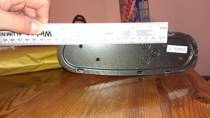

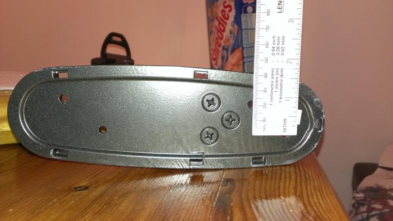

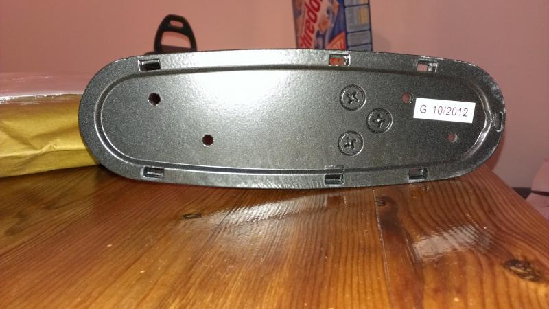

Hi all,
I have a TV mount which I want to mount on the wall, but I want it slightly further from the wall so it goes into the room a little bit more, so I want to put some wood on the wall and attach the mount to it.
The screws to hold the mount need to go 55mm deep, so the wood needs to be at least that thick.
There are two sets of holes on the mount. 13cm from each other and 2cm apart.
Here are some images of it on its side.
I was thinking two pieces of stud attached to the wall horizontally, one for the top row one for the bottom, with one screw on each end.
I was thinking of some wood like this.

Personally I'd go for a purpose built tilt and swing bracket (Toolstation 93962 is an example)......but if you want to go your way, consider fixing timber to the wall first, and then the existing bracket to that.
The bracket itself could hide the timber securing screws too.

Thanks for your reply. That's exactly what I want to do - but was wondering what the best way to attach to wood to the wall is. Screws, angle brackets or those "basket things" to hold joists.
