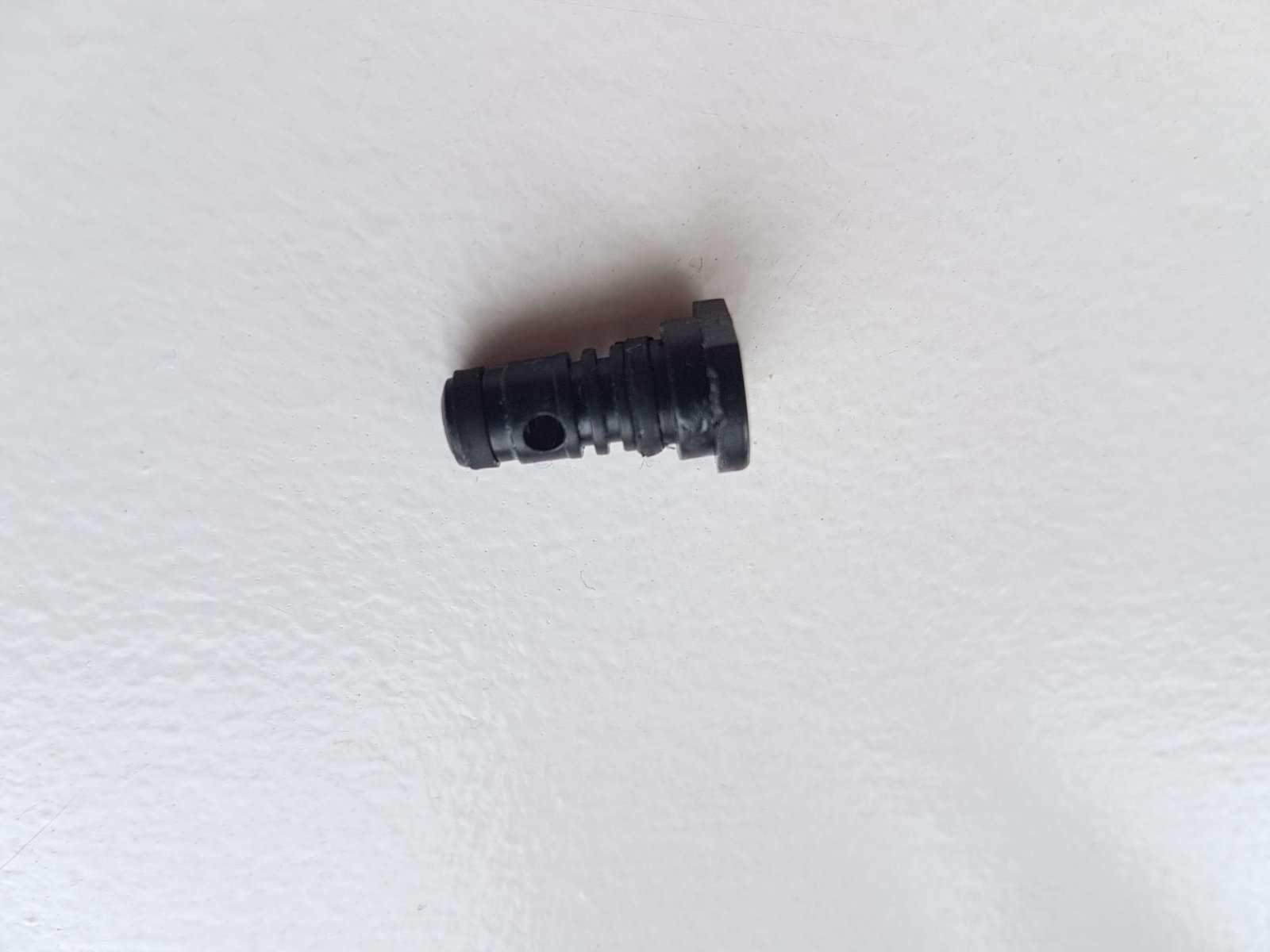

one other thing on the idle jet which is he plastic piece under the idle screw i did have a couple of splits orings which was the fault of the high reving when i got it going but managed to grind a couple of orings down to get me by does anyone know where i could purchase these from

Your idle problem is sure to be a carburettor issue I think, and I'm not too sure about the plastic piece under the idle screw. ...a picture would help?

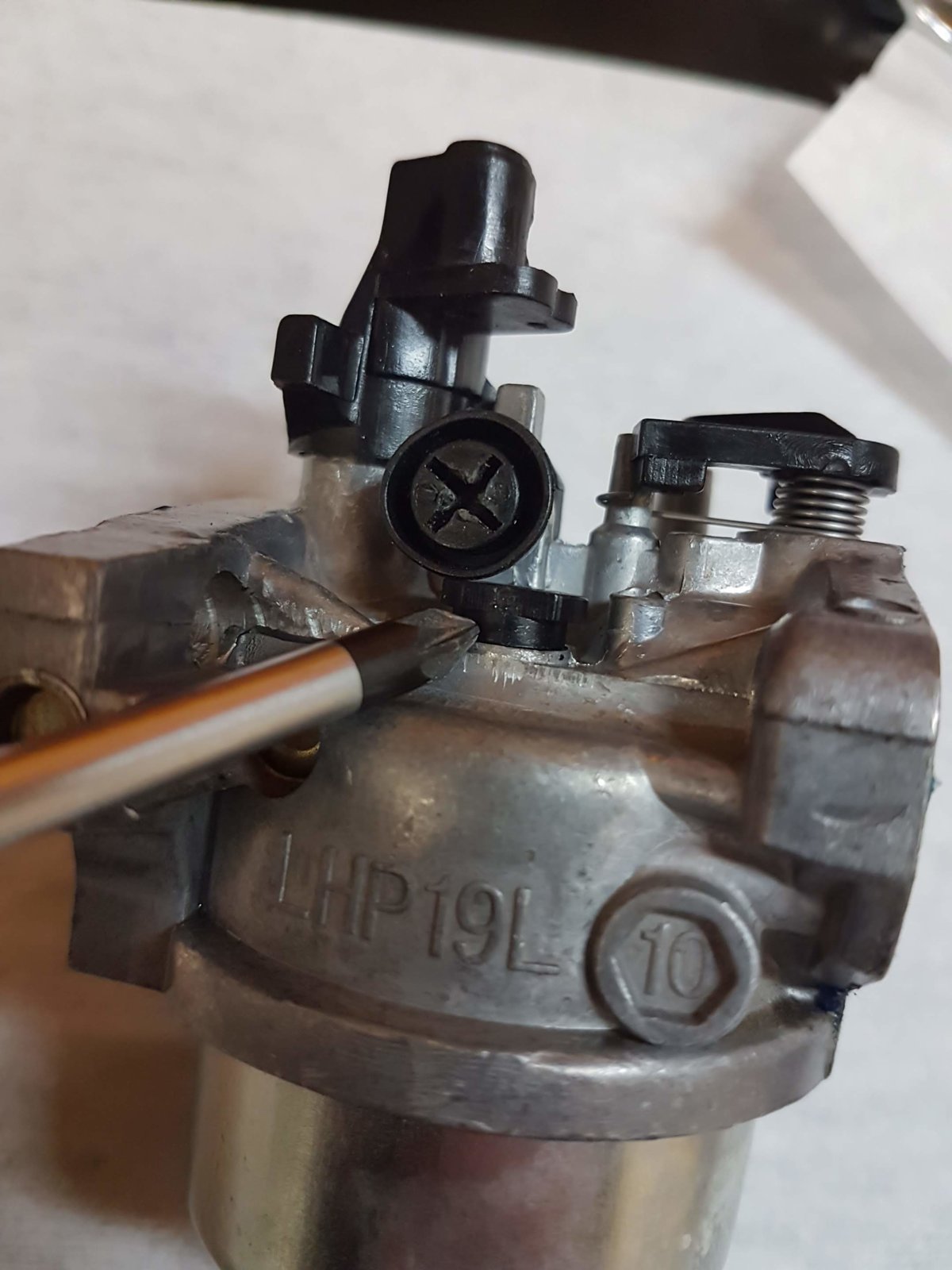

well today ive removed the flywheel and all is good there no broken keyway :) also tryed the mower with a charged power pack and it seems to turn over slowly but did go so ordered a new 5.5 ah battrey so will check power when turning over then .is there a charge circuirt on the mower then john like an alternator .iIve also stripped the carp and added a picture of the small plastic jet i was on about and spoke to ghs but they couldnt help but could supply a carb at 76 plus vat ,just cant warrent buying a new on when i know this ones good ,just a risk on the orings in the future .currently got it running ok with only a slight hunt so will have another play if i can source some small oring just incase ones letting fuel buy or starving it

Pity about that jet issue though, it's a poor push in design and the O rings do need to seal.

That jet looks the same as the one on Honda pro engines and is often overlooked when diagnosing starting issues .Its kept in place by the tapered plastic idle speed screw.
