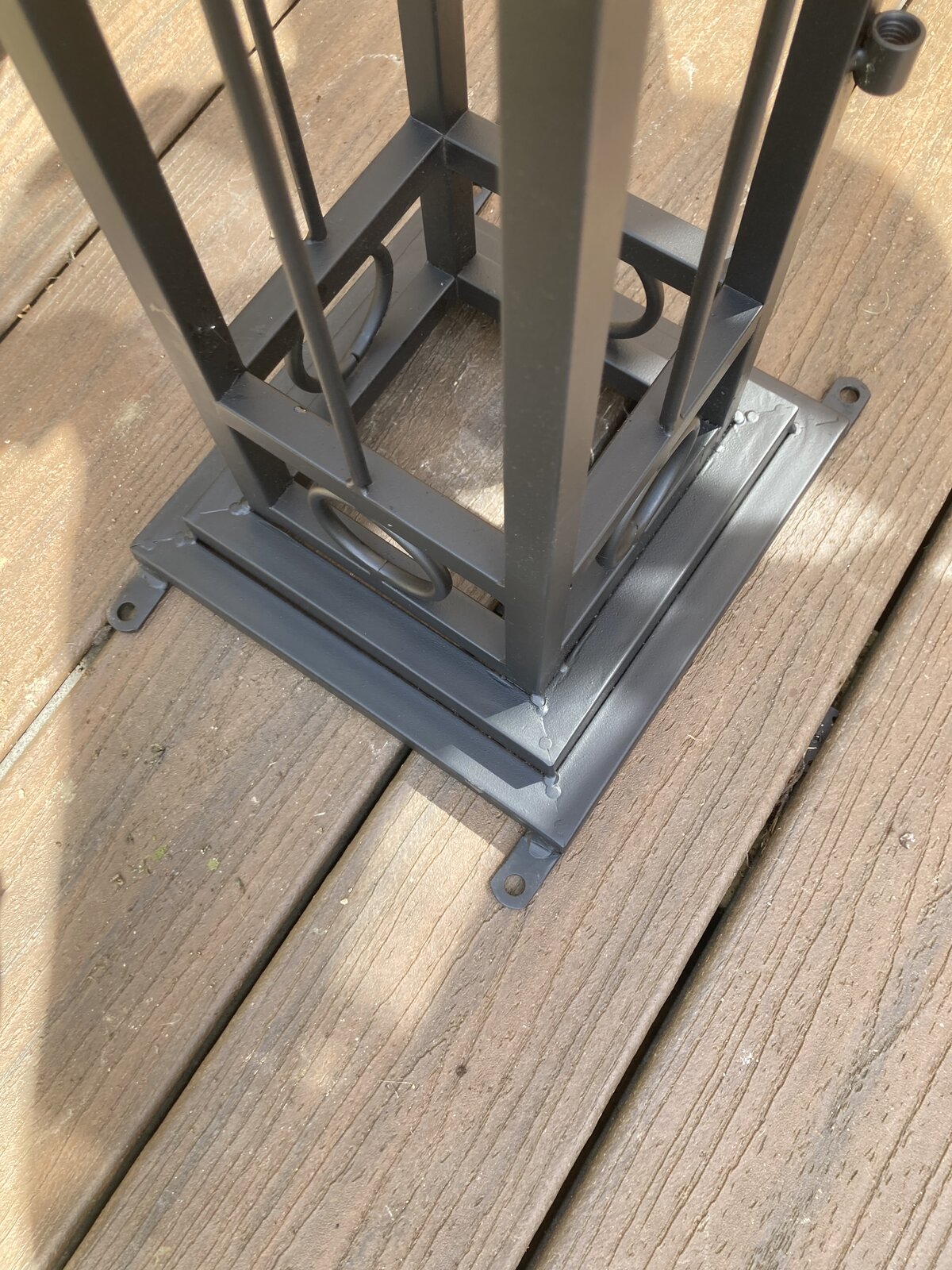

Hi, I have a gate to put on to a path which is finished with self binding gravel. I need to get a good foundation to bolt into - see photo - what would anyone recommend doing?

Whatever you fix the feet to, concrete slab or sunken sleeper, if possible its best fix the post to the wall it will stand against, to reduce the gate levering it away.
