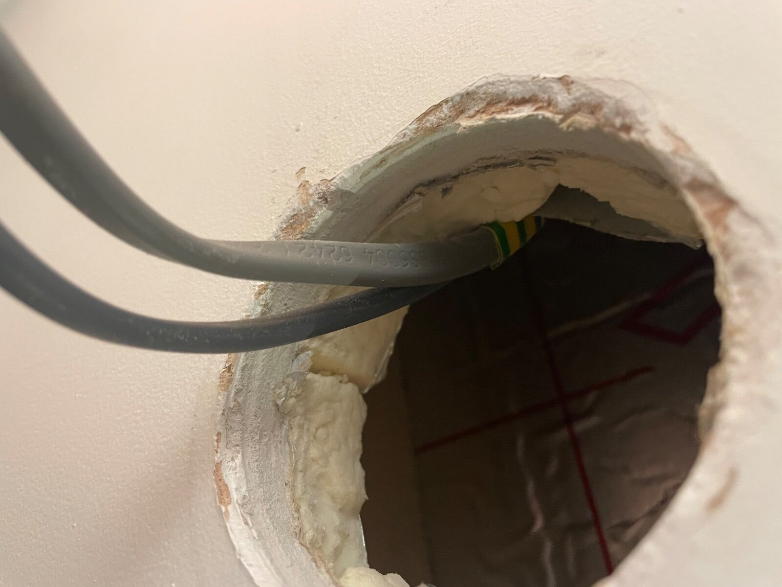

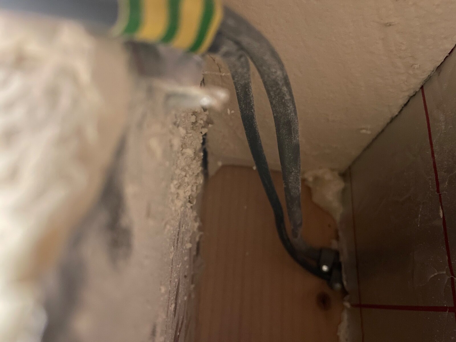

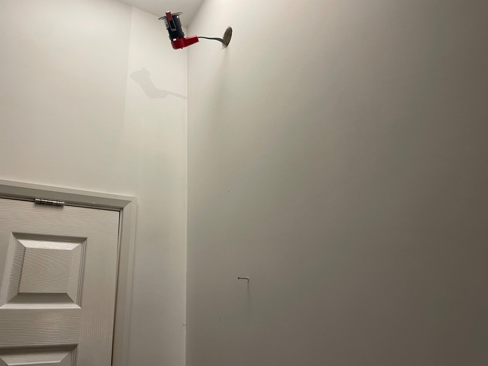

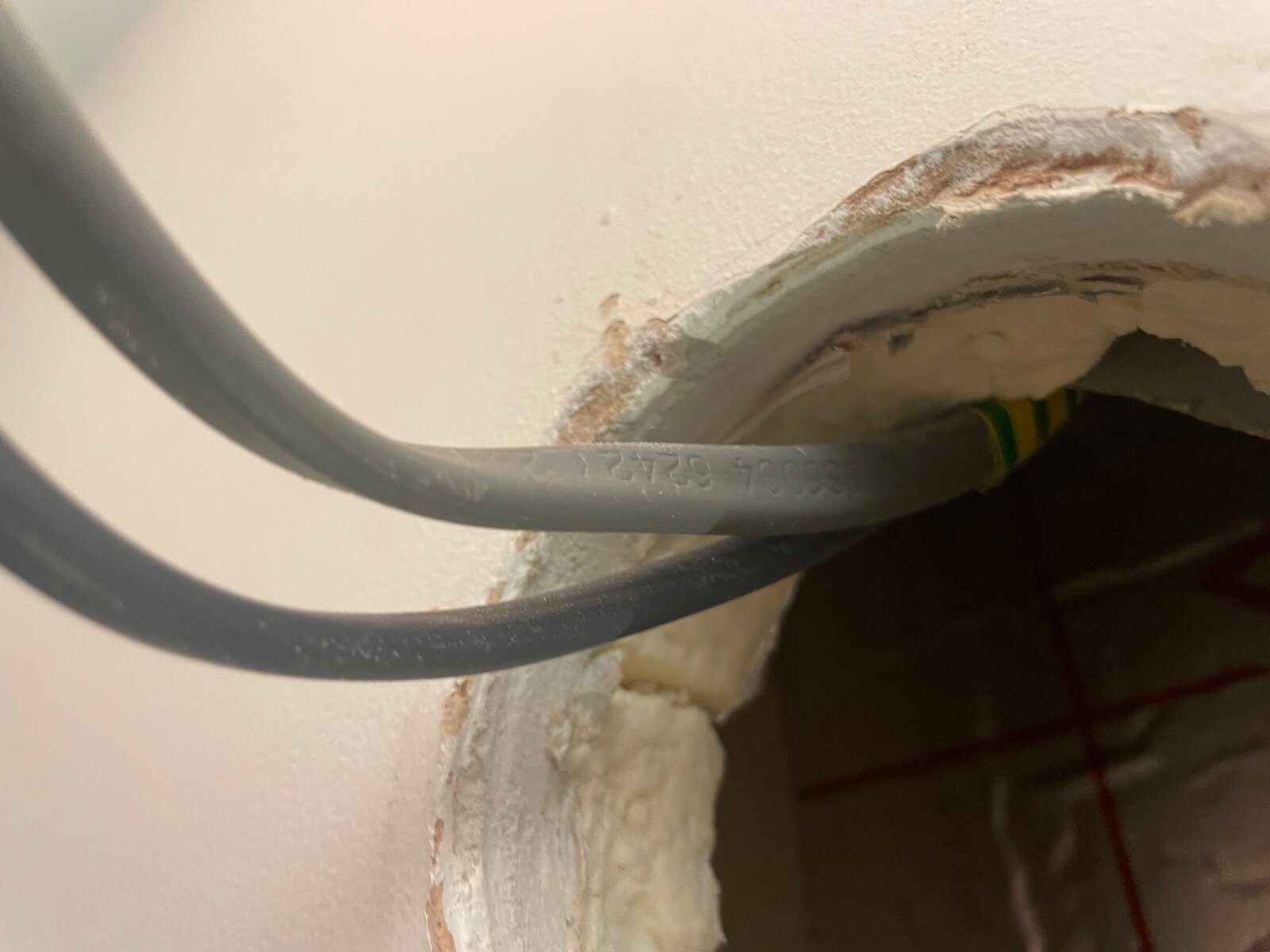

Hi, I am building a walk in wardrobe in my bedroom that is a dormer roof, I moved the center light quite easy as the void was above the insulation, but the lights in the corner of my room I need moving about 1 meter forwould looking at the these lights it’s packed with PIR insulation right to below the roof as I can see any void to feed the cable can anyone advise if this is possible ?
So I don’t know if I have a cold roof or a hot roof?

That's a cold roof by the looks of it.
You can get surface mounted led lights leaving the ceiling and insulation intact.
I never liked drilling those ceilings but you can and people do.
