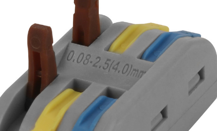

Hi all,
I need to move a 2gang plug socket 2ft horizontally across the wall. I will be keeping the old (metal) backbox and putting a blanking plate over the old socket.
To extend the wiring (which is ring main), is it sufficient to use 2 x three pole levered connectors like this one from Toolstation?
Or should I spend the extra and buy 6x Wago 221-2411 inline connectors?
In either situation (Toolstation or Wago) do I need to wrap these connectors in some other sort of housing?
Thanks in advance
Yes.
Not if they are in a back box with blank cover.
BUT:
Why don't you just leave the socket in place and run a spur from it?
