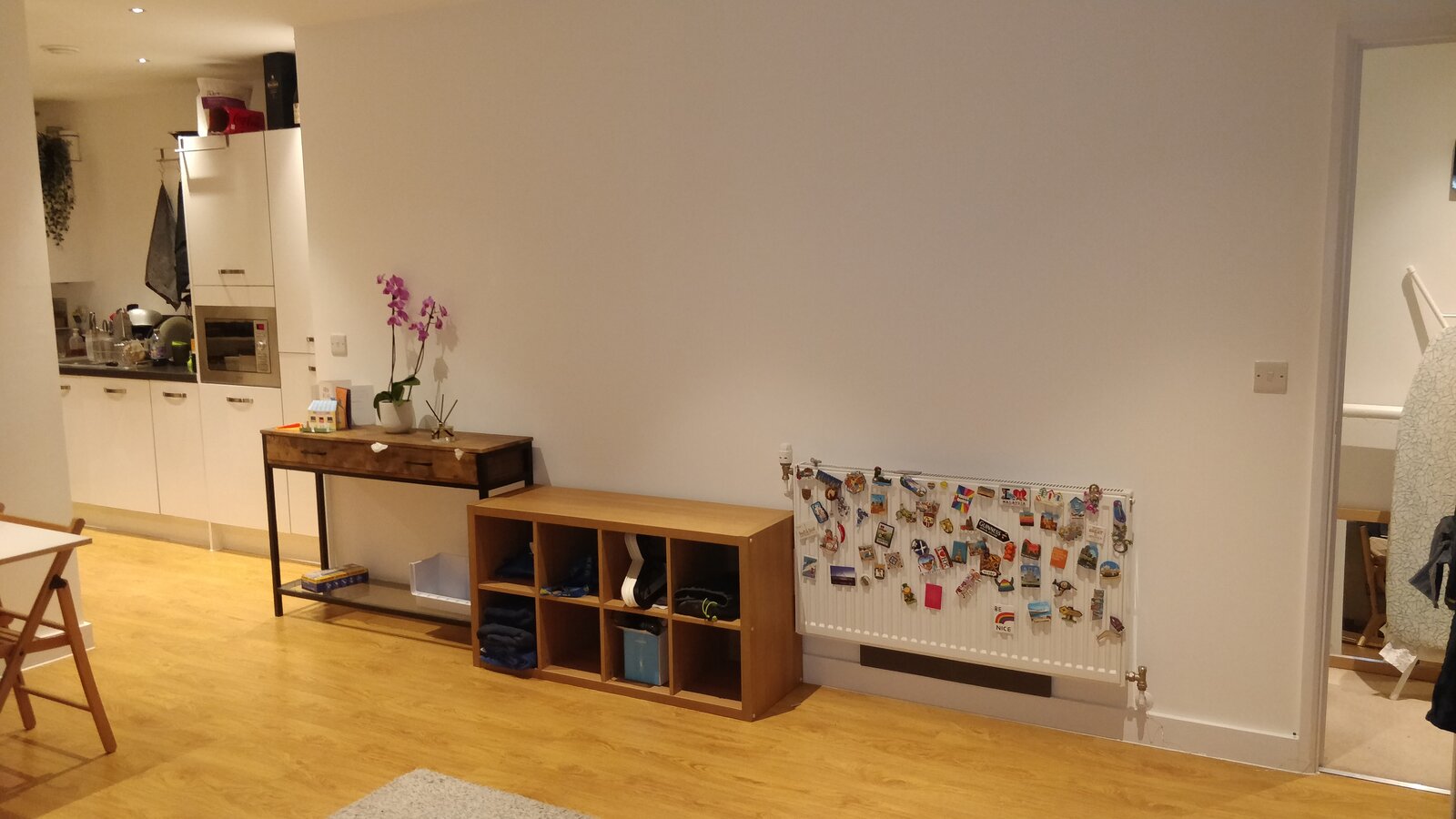

We are wanting to move a radiator around 2 meters to the side, as we are going to be placing a TV where it is presently located.
Also thinking about getting a slightly snazzier style to fit in with the syle of the flat (the present one is quite normal/average)
This is definitely not a job we can do ourselves so will get someone in, but is there anything to consider when getting a new radiator. size, heat output, positioning etc.
And is this a big job for a plumber? anything to consider here with options?
edit - On a side note, would I be right in thinking we should NOT place a brand new large TV in front of a radiator?

1. Measure the height and width of your existing radiator. Check to see if it has one front and one back heating panel and whether it has "fins". between the two. From the picture it looks like a type 11, which has a front heating panel and fins behind that panel with no rear heating panel. Use the dimensions and height to look up similar radiators to get the heat output.
