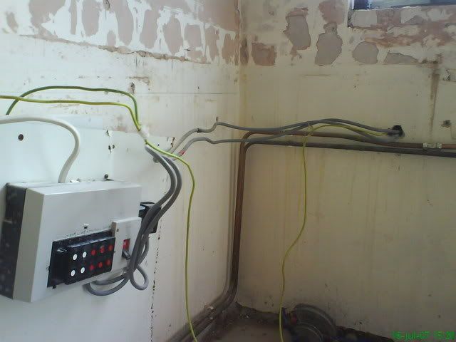

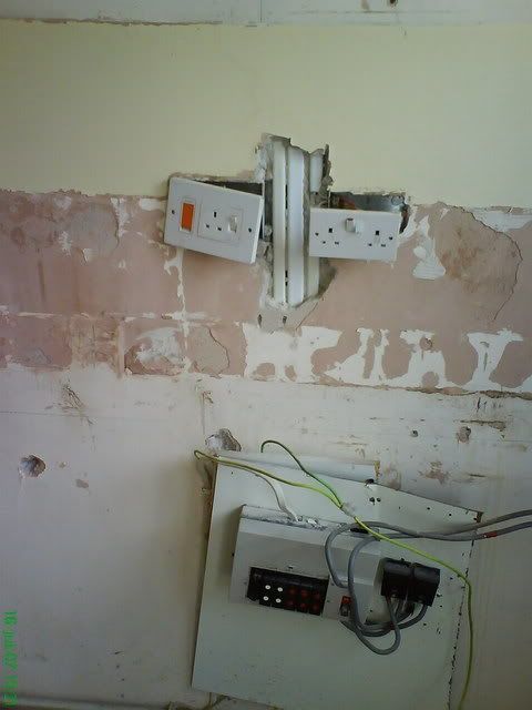

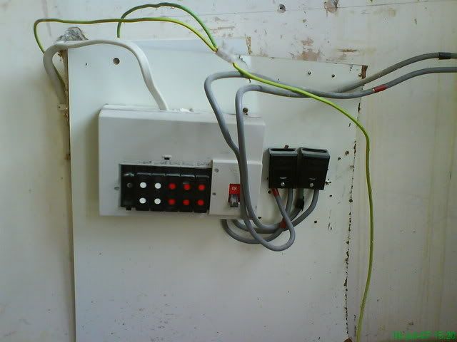

got a CU in a kitchen base unit. 16mm tails come thru the wall from the cut out which is in a box outside. Got to move the CU to the wall unit directly above where it is at the moment. Is there a maximum distance that it can be moved from the cut out and wot are the rules on protecting the tails. Presently they just run around the units to the CU.If i run them up in the corner should they be in trunking. Im assuming that they cant be buried in the wall even if they are in safe zones i.e the corner. cheers
There is nothing in BS7671 requiring special protection for tails but many DNOs have thier own rules over what length of tails they will connection and what if any protection they require.
The way I would do it would bo to install a switch fuse in the meterbox.
Then use the switch fuse to supply a 16.0mm² cable.
This cable can be as long as needs be, and it is fine to flush mount this cable, providing it is in a safe zone.
My cable of preference between the switch fuse and the CU would be split concentric.
ok. why split concentric rather than normal 16mm tails? Can you give me an idea of a suitable switch fuse cz the ones i know of are really expensive

as u can see in the pic the cables come down the
wall so it means just shortening the cables.
Also most CU's are in some kind of cupboard so wot
difference if its a kitchen wall unit?
I can just leave the back panel off and fit it to the wall
Its gonna be changed to a new split load board by the way
