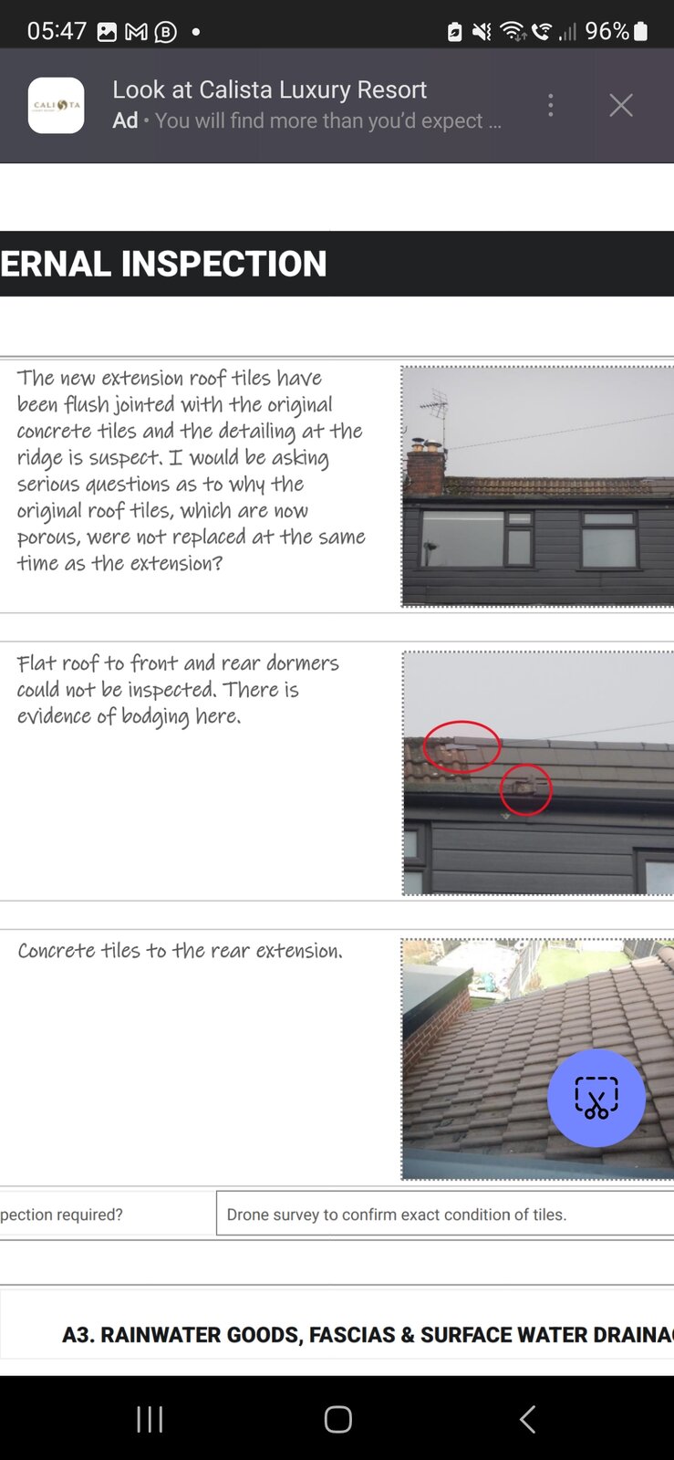

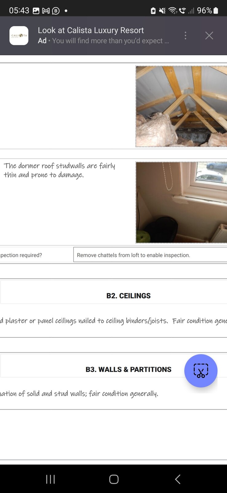

Good morning
First post here but would appreciate help from those with more knowledge
Survey report back from 1960s dormer with rear then a two storey side extension
Can I please get a few thoughts and opinions on points raised in images
Thank you
Kris

Jesus, was that written by an apprentice?
Generally clueless commenting, and the stupid font and first-person writing would make me question the professionalism and knowledge of the surveyor.
You might want to ask specific questions of your concerns.
Appreciated

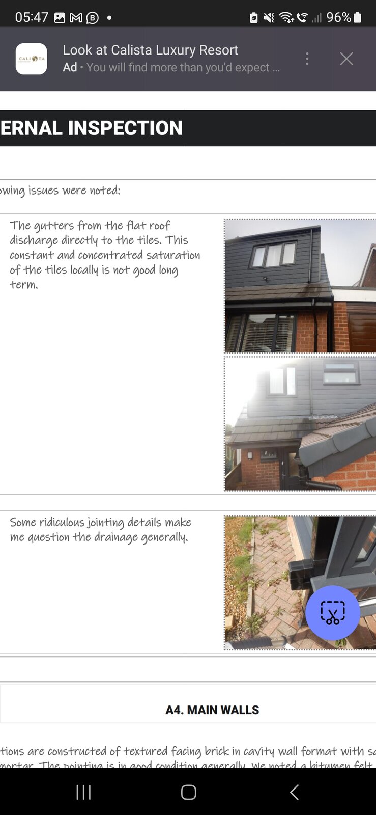

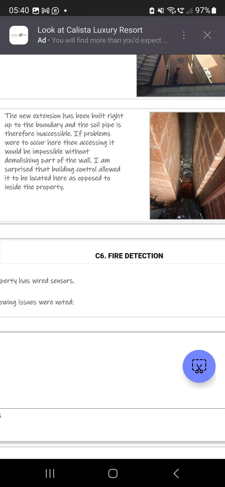

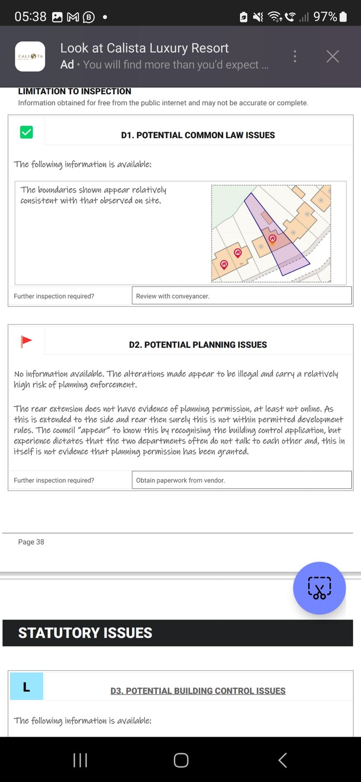

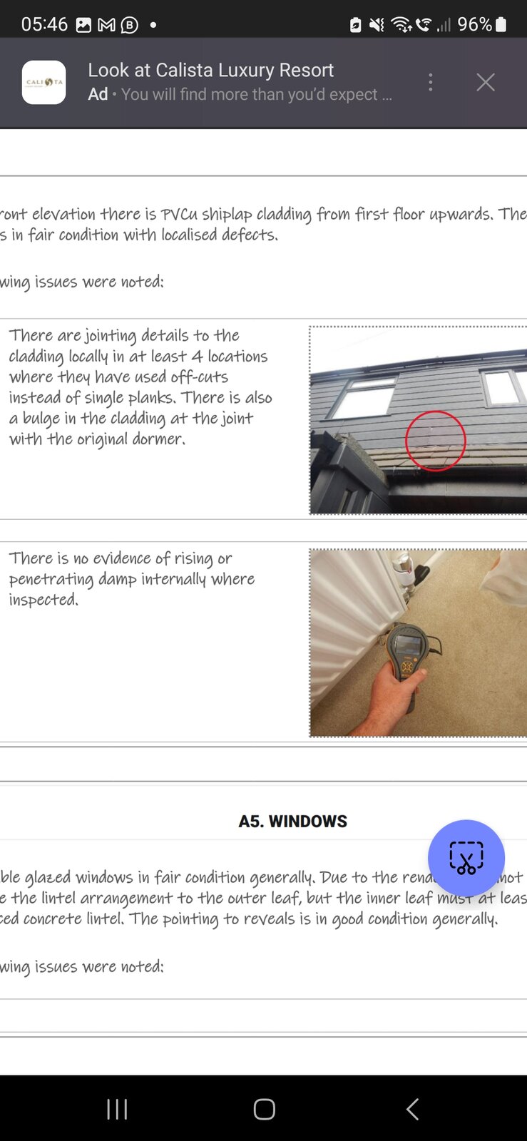

I'm more focused on the points raised prior to purchase of the property such as is there an issue with cladding bulging at the front or where old and new roof tiles are joined when you read the word porous automatically you think something that allows liquid through
Be aware that surveyors will put down everything to cover their butts. You have to read between the lines. Might be worth getting someone you know and trust who is experienced with buildings to look over the report and the house.
Try not to worry about it though...
Eh?
Its an an assessment/opinion. It's not like an SE's calc's.
Surveyors always cover their own backs...they put down recommendations that can be pure bs...i know as i have seen enough of them over the years..
