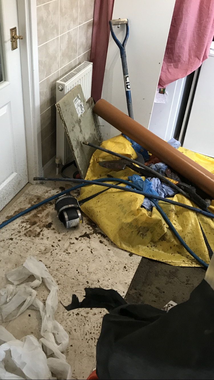

Pictures of the side of the house and the under bath area(y) and general bathroom
Managed to get under the bath but it was dark when I got home from work.
There is 150mm between the current end of the bath and the soil vent pipe. And as you can see there is a pretty big boxed section in the corner of the room which we'd like to get back if possible.
View media item 100517
View media item 100518

Yes. Put as many bends as you like in the dry section.
Cool, so what I’m thinking then is if that white pipe from the sink is run lower down nearer the floor I can then get a bend above it to move the vent pipe right up to that wall corner and have a much smaller boxed in section.
