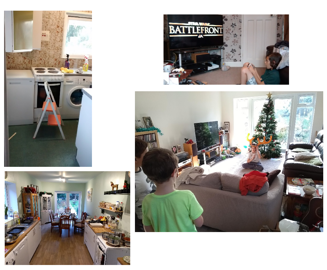

Some inspiration ... our 1930s bungalow kitchen and lounge, before and after the extension (yes, not bought a new oven yet)
The kitchen cost about £2000 (inc fitting), the floor was £500 sheet vinyl (inc. fitting).:

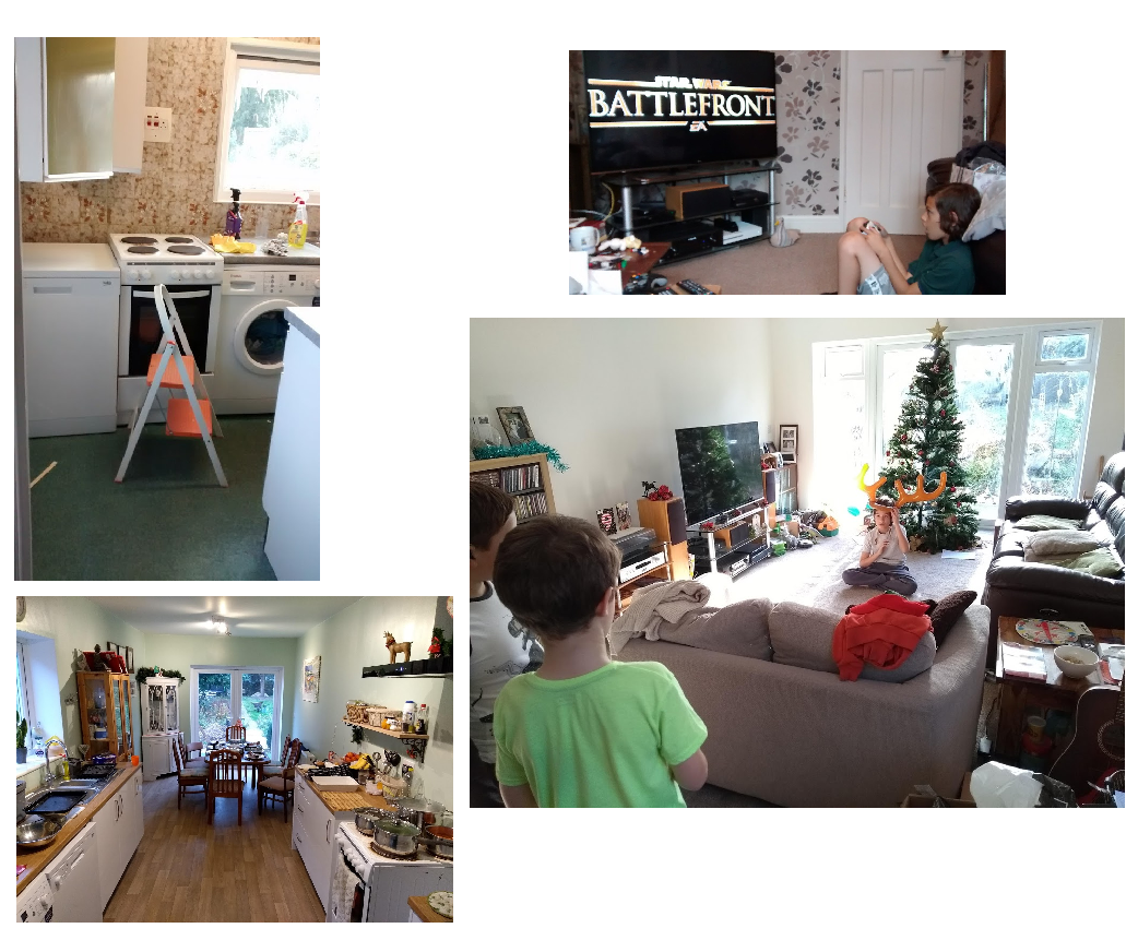

Nice build by the way, that's quite a turnaround. There seems to be a lot of love for the 1920s/30s built houses on this forum.
