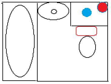

I'm wanting to move the soil stack about 1ft to the right of it's current position.
It's cast iron.
Having read about cutting etc it all seems straight forward (not in a hung ho way of course)
I'm wondering about connecting it back up in the attic.
At the moment the soil stack goes out through the roof.
If I cut it off in the attic and redirect using PVC pipe can I just reconnect in the attic?
My concern is the weight of the remainder cast iron on the roof connecting back into the PVC.
If I didn't connect back into it and used an AAV can I just cap off the remainder cast iron stick through the roof or is this just inviting a leak?
The picture isn't quite to scale :) The blue circle is the current soil pipe. The red is where I would like it to go allowing me to push the toilet back against the wall.

I would reconnect in the attic, avoids any possibility of a leak and any pressure problems caused by removing the open vent. If you cant replace the top section with plastic, then I would look at manufacturing a cradle in the attic to support the remaining iron. You really dont want that falling through the ceiling, especially if someone was using room below at the time..... :eek:

Perhaps some advice of how to cut that cast iron pipe would be of some use. Personally I think it's going to be a struggle and it'd be worth trying to get a bit of cash together to get someone up their to install a tile. :confused:
Cutting metal soil pipes needs to be done with an angle grinder and a good quality metal cutting blade, support the pipe while cutting.
